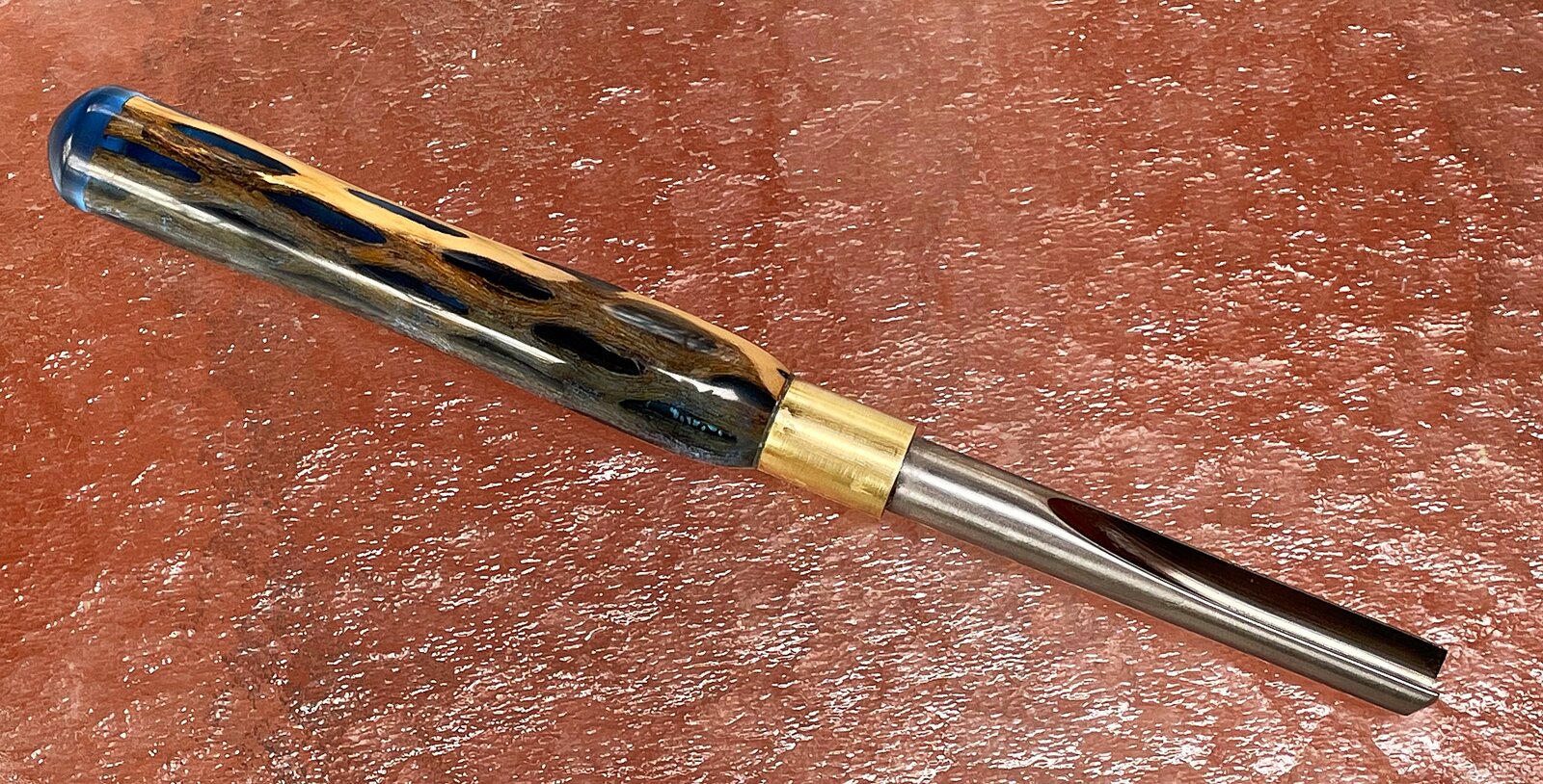

Despite turning countless pens, I have never settled on a go to chisel for pens. I've noticed that as I turn larger spindles I have gravitated toward using a roughing gouge more and more. This has carried over into pen turning where I do all but the final few passes with a large roughing gouge. I then switch to a small skew. My skew is a cheap one that I got in a set when I first started turning and it's reaching the end its useful life. I was never happy with it in the first place. So I decided to buy a Sorby Micro Roughing gouge and put a cholla and resin handle on it. I turned the handle with the micro gouge straight out of the package without any handle. With the handle I should have greater control and I think it will do well for pens from start to finish. I am going to sharpen it and do a slim line without sanding and see out it turns out.

Love the tool handle by the way.

Beautiful handle Cody.
