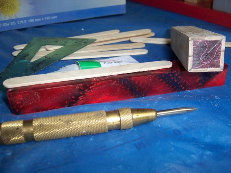

To hold a square blank together while drilling ,use thin CA glue and wooden ice cream / pop stick's, glued the pop sticks to the out side's of the blank, On a 3/4 inch blank 2 sticks each side then trim off the edges. also before drilling you can turn the blank round between centers then wrap the blank with string and soak it with thin CA then drill it out.
Yup, and that reminds me that I drill my segmented blanks in a four-jaw chuck with splints on each side, similar to a popsicle stick but as wide as the blank. I don't glue them on because the chuck jaws keep them in contact with the length of the blank. Of course, I make the blank square on my disk sander before drilling, and cut them to length so they fit into the chuck without a lot sticking out.

To hold a square blank together while drilling ,use thin CA glue and wooden ice cream / pop stick's, glued the pop sticks to the out side's of the blank, On a 3/4 inch blank 2 sticks each side then trim off the edges. also before drilling you can turn the blank round between centers then wrap the blank with string and soak it with thin CA then drill it out.[/quote]
gluing /turning blanks
Spent half a day looking for these photos :rolleyes: anyway Some photos of a segmented wood and aluminum blank which was wrapped with string and soaked in ca for holding the blank together while drilling and turning on the lathe.

I could'nt find the photos of the segmented wood and aluminum blank which had the pop sticks glued to it before i turned it round it was a few years back:rolleyes:.Anyway I did find 2 photos of a acrylic blank which i glued wood pop sticks too, i do this for another reason, it's for drilling a small 5/8 blank for the bigger kits, a bit more meat on the bone,save$$ :biggrin: also keeping the Acrylic blank cool while drilling i use DNA in a spray bottle and spray it on the drill and into the hole, great for stopping heat/cracking.
