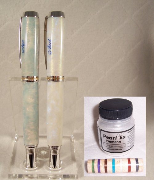

You don't HAVE to color your tubes, I never do, and instead I enhance the blank with a little added shimmer.
Rather than paint I use epoxy and mix in a very small amount of Pearl-Ex metallic powder to make the color I desire. No hassle, no glue marks, no bubbles AND it adds some pizzas to your pen blanks.
The two pens in the photo have the exact same blanks, the one on the left had a little turquoise powder mixed with the epoxy, the one on the right had white diamond powder mixed in the epoxy.
This stuff is very reasonable and can be found at Hobby Lobby and other craft stores.
Below the bottle is a sample stick I made showing the colors I have (there are more). This powder, mixed with epoxy or CA can also be used to add decorations to pens as shown on the sample rod.
