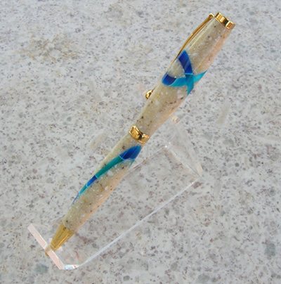

I have some corian, at least that is what the supplier said, that is about 1" thick. I actually haven't tried gluing corian to corian. I have segmented with acrylics and can't see a line. Heres one I did for someone. Corian is cut and sanded with 320 grit and the acrylic was lightly sanded also. Used Medium CA glue and only let it set up for a about 30 minutes with a clamp.
<br />
Sorry about the light background, realized it after I took the photo.
Originally posted by drawknife
<br />I have some corian, at least that is what the supplier said, that is about 1" thick. I actually haven't tried gluing corian to corian. I have segmented with acrylics and can't see a line. Heres one I did for someone. Corian is cut and sanded with 320 grit and the acrylic was lightly sanded also. Used Medium CA glue and only let it set up for a about 30 minutes with a clamp.
<br />
