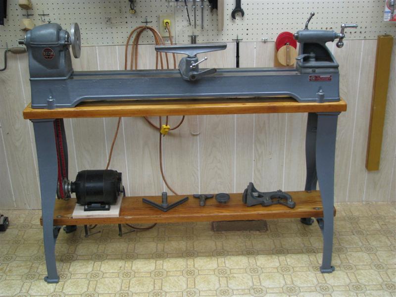

Hello all; I am presently turning pens on a Delta/Rockwell lathe Model 46-305. It has a slight more shavings than this picture shows at the present time.
I purchased it used in Dec. of '07 and reconditioned it in it's entirety. I also have a Delta Midi out in the garage which I was going to install a Beall system or the like on, but have never gotten around to it.
