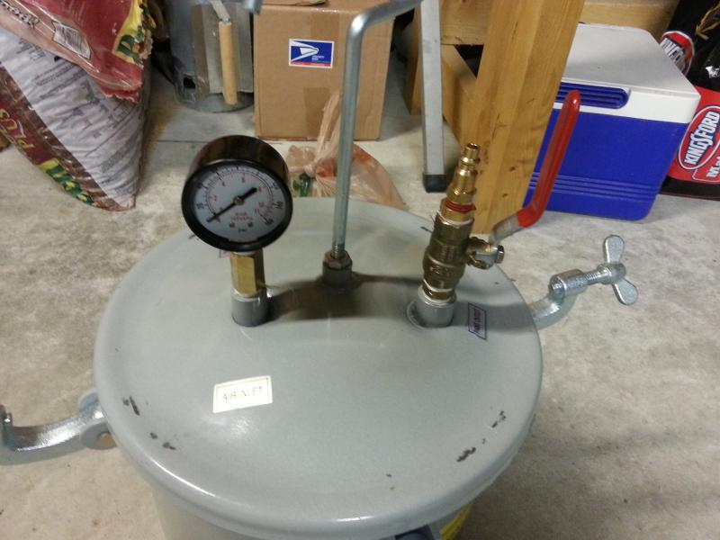

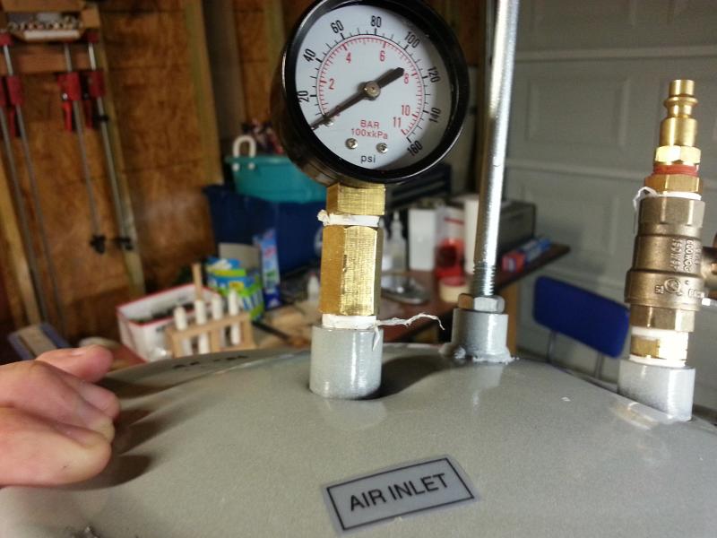

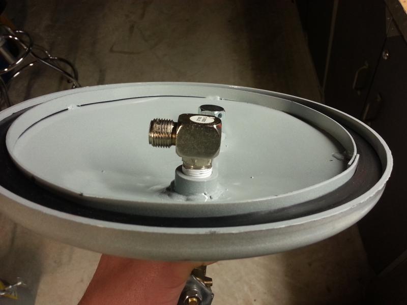

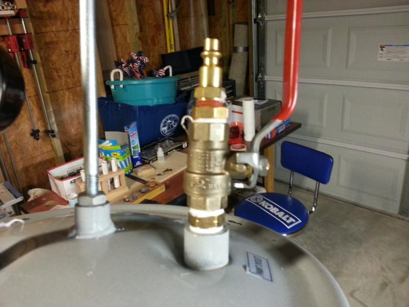

Mordi,
I already threw away my receipt so I can get you all the part numbers. My promise to keep my garage cleaner and all. I do remember how I put it together and the parts that I used. **Disclaimer**, I have a very basic set up that works for me, so use at your own risk!! On the lid there is a 3/8" elbow. I took it off the top and unscrewed the paint pick up tube. I then installed the elbow on the underside of the lid where the tube was. I then took off everything from the top of the other side. I installed a male double ended 1/4" fitting, a double ended female 1/4" fitting and then a 1/4" air gauge. Now back to the other side where the elbow used to be, I installed a double male 3/8" fitting, a ball valve, then a 3/8" male to 1/4" female adapter. I then finished it off with an airhose quick disconnect adapter. That's it. It's really easier than it sounds. I have no regulator or blow off valve on mine. I'm good with that, but you may not be. Choice is all yours man. Hope this helps. Pm me if you have any questions.
Dave
Pics
Mordi,
Here's some pics to help translate the last post. Hope this helps.
Dave
