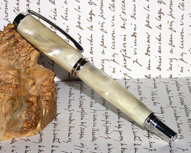

Here is one I just finished for a customer... Pearl Pipe Material on a Platinum Jr Gent...

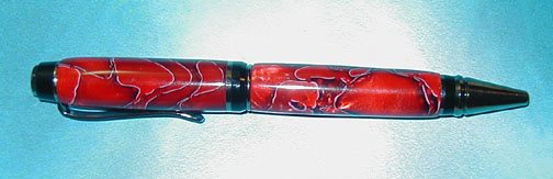

Griz, I'm still a newbie here compared to some and don't really know the difference between acrylics, plastics or celluloids, but I've turned 2 Celluloids and do it very much like you do.I round my corners off very slowly, tiny bites with a gouge until it's round enough for my skew not to bounce around. Then I work back and forth with my skew taking off tiny ribbons of material, dang stuff is static prone so I'm wiping it off my skew as much as I'm cutting. I get it down close to where I want it and check for gouges or holes from chip outs. I f there isn't any I turn it on down and then sand lightly with somewhere between 240 and 600 grit depending on how much is left of my skew marks. Once I've got it smooth and are sure there are no marks or holes I switch to the pads used for Acrylics or corian, using water and wiping between each grit. once I'm down to the last pad, 12000, I believe , I use a polish I bought at Woodcraft. I'll have to wait til I get home to tell you the name, but it's simuchrome or something like that. once done its`as smooth and shiny as glass. Heres a red celluloid I've been meaning to post.
