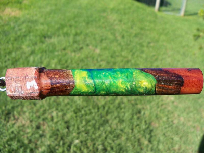

I got my first shipment of resifill blanks from George this week. I turned my 1st one last night. I've turned several pens since my "1st pen" post last week. This was very challenging for me to turn through two different materials at the same time. I also made my first attempt at a CA finish. Didn't turn out so well, but I learned some things in the process. Overall the pen turned out ok, but not near as good as I'd hoped for.
When I edited the picture, I used s soften effect. It took the shine off of the pen. It does have a really nice shine to it.

Gezzz... mate, you haven't wasted any time, huh...???:wink::cool:
You are a brave person in getting into those type blanks, still in your very beginnings of pen turning, they can be challenging to say the least but it have done a great job with it.

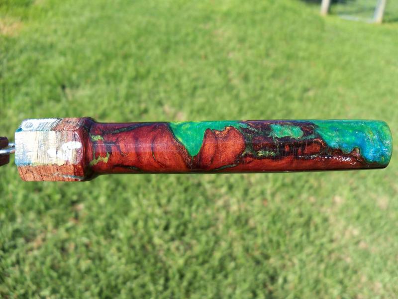

That is one of the last Resifills I've made, from the Colonial Red Gum Burl I got recently in the green/blue/yellow resin, the blues and whites with that same wood should come up pretty neat too...!
Well, you have a few to play with so, you've got work to do.
Good luck, looking forwards to see some more...!
PS: I finish these Resifill blanks exactly the same way I do with the wood only, 2 to 4 coats thin CA and then 4 to 8 coats of medium CA, depending of how porous the wood is, which this Red Gum Burl is not...!:biggrin:
Cheers
George

Thanks George, I will take some better pictures of this pen. I will turn this thing around and try to get a shot of the wood. The wood grain really pops!
