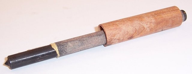

Another method....
I take one of the Harbor Freight transfer punches, apply a few drops of CA and wrap a piece of sandpaper around the punch. I put the punch in a drill motor and slowly rotate the blank around while running the drill really slow. I also use this to clean out any glue inside the tube and one punch works on lots of different pen blanks and tubes. Works well for me.

Another method....
Another great idea to store in the ole memory bank ;) for the day I start making these pens . :good:

Dang George weak....er great minds think alike! I use one of the transfer punchs and after wrapping some 400 grit around it chuck in in my Beall and lightly run the blank on and off it checking often until the tube slides in easily. I stumbled onto this when Ken changed the way his Flag pen kits are made and I needed a way to sand the insides of the blank after gluing the stripes in. Just don't get too agressive and rotate the blank as you slide it back and forth.

I have been using the same method with success just float the paper though

Thanks so much everyone for the suggestions. I did wrap some sandpaper around a dowel (just like using the transfer punch) when I had the problem, but was hoping that maybe there was an appropriate size drill, evidently there is not or someone here would surely know about.
