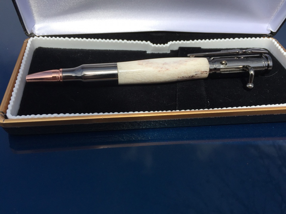

It is a very attractive material, though somewhat unpredictable.
Especially nice with the bolt action pens.
