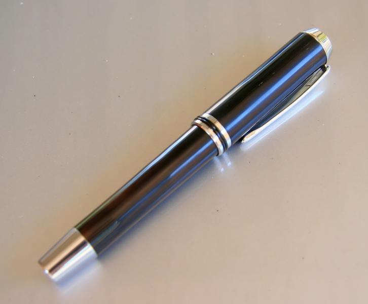

Turned a bit of Gemsbok horn yesterday. Very easy to turn and finishes well without CA or other coatings. Quite difficult to get all the minor scratches out, sort of like acrylic in that way.
I sanded this one starting at 220 through to 1200 then MM through to 12000 and finally buffed.
Found it quite difficult to photograph this one and the best pic came out with a dirty background and the DOF being a bit shallow!! Anyways, here ya go.
Thanks for looking and have a super day :)

That is a beautiful pen !! I've never seen a Gemsbok horn nor heard of the animal.:rolleyes: I think it has to with being in Texas:eek:. I think putting the picture of the animal with the pen was a neat idea. Great job. Thank you for showing! Regards, Doc

Beuatiful pen! I think I'll have to try horn one of these days since they turn out so amazing...then again mine may be a disaster. I'll just keep looking at your pen, ha ha ha.
Great looking pen!

Thanks Tim, its actually very easy to work with - you should give it a try. In fact I've got a spare piece here that's big enough for a Sierra - PM me your address and I'll post it to you :smile:
