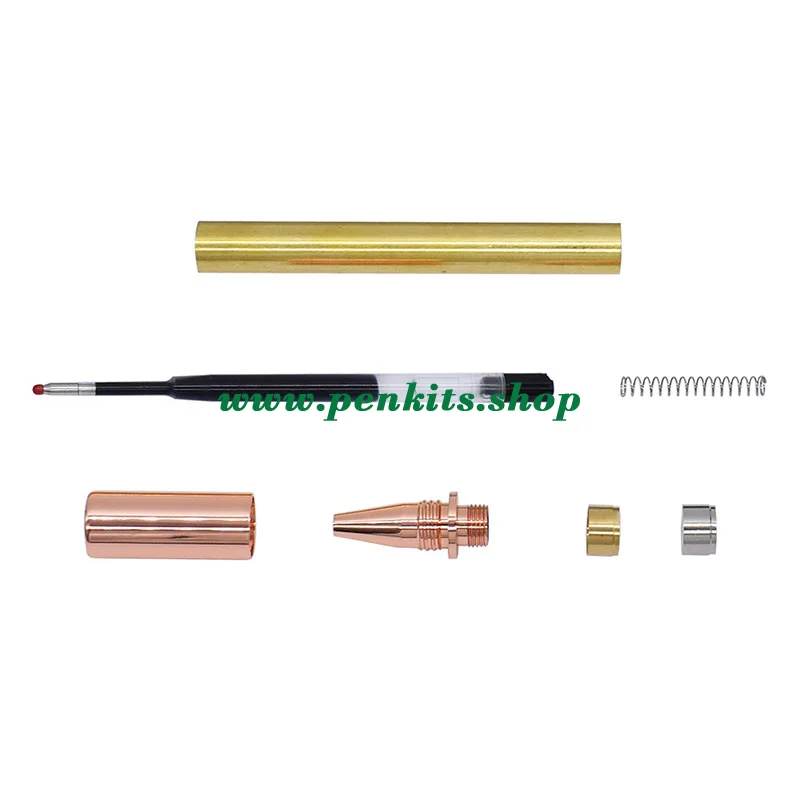

New Nyoibo pro gel pen kits
  • Like
Reactions: Big
Gels are usually associated with any pen that accept a Parker-style ballpoint refill. Montverde and Parker make good gel refills. The are more wet than your typical RB and do run-out more quickly, but I like them.
