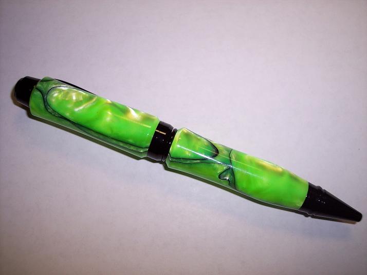

man this stuff is a bear to turn. I had to glue pieces back on this blank three times. The first blank split while drilling. Where there is a black line it came apart. It seems as though the black material did not get proper adhesion in the cast. This thing is bright, it glows like day glow rods in the light. Has anyone else tried turning this material? I bought it in the group buy from woodpenpro.

Ditto, but I like the way it looks. I have a friend that is going to kill to my pen, when I turn it, if it looks anywhere near as good as yours.

I have not turned them yet,but it looks like you made it![:)]
Great looking pen!
This one made it to the lathe, but I had to glue pieces back on. I used a radius skew that I had just finished honing and it still broke. It broke cleanly so it went back togther well.
Andy

I had one of these green blanks and it also cracked when I drilled it[V]. It split right down the black line. It was pretty easy to reglue it with CA and clamp it back together. Put it together with a black Ti Gent Jr II and it was the first pen I sold the next day[:D]. The girl who bought it said she could see it across the room.[8D]

I just drilled a Geck blank for a Cigar pen I wanted to test out. I had no problems at all and the drill went through very easy. You guys had me worried. I went about 1/8" at a time and wet the bit down as I drilled. i do this with all resins and so far, this method has been good to me.
The first one blew out while drilling. It had the most black swirl in it. This blank made it through drilling fine. When I was making my roughing cuts it came apart the first time. The good thing is it split on the black line so glueing it back together was easy. I did notice that the black material was shiny. I was thinking that the resin could not bond well with it so I scuffed it up with sandpaper before CA'ing it back together. Good luck with yours. Everyone who has seen it loves it.
