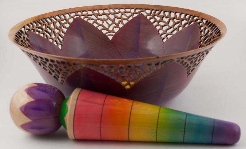

It's almost gardening time so made some garden theme things.
Pierced and airbrushed floral pattern bowl with matching airbrushed gardening dibble. Bowl is turned from sycamore and dibble is turned from maple. Bowl is around 9" (23 cm) across. Dibble has marks every inch (25mm) to aid in planting bulbs. Bowl is finished with polyurethane, the dibble is finished with PolyWhey, a whey protein based finish made from byproducts of cheese making.
Eric that is a pretty bowl and I haven't seen any one else turn a dibble before, I have to make sure my wife doesn't see this or it's going to become a honey do thing, great idea though, looks a lot better than my stick with marks every 1/2 inch.
Thanks, the latest club challange was to make a garden dibble so I decided to go for a double header and make a second turning with a matching theme.
