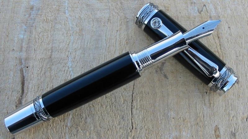

S schellfarms Member Joined May 28, 2006 Messages 109 Location Holly Springs, Mississippi, USA. Sep 21, 2008 #1 Majestic FP in Black TN and Rhodium that I made for a co-worker. Attachments Ebony Majestic.jpg 64.7 KB · Views: 324
rdunn12 Member Joined Dec 2, 2007 Messages 1,098 Location Gardendale, AL, USA. Sep 21, 2008 #2 Stunning!Yep that sums it up.Great work.
bitshird Member Joined Aug 27, 2007 Messages 10,236 Location Adamsville, TN, USA. Sep 21, 2008 #3 That is OH SO Sweet, Just something about a kit with some bling, dressed in black, they look so elegant and unaffordable don'tcha just love em

desertyellow Member Joined Apr 28, 2008 Messages 1,260 Location Las Vegas, NV, USA. Sep 21, 2008 #4 Very Cool!
toolcrazy Member Joined Dec 23, 2006 Messages 5,408 Location Port Orchard, WA Sep 21, 2008 #5 Gorgeous pen. Blank fits the kit. Nice work.
Bear_Knuckle_Turner Member Joined Jul 2, 2008 Messages 73 Location New Market, AL, USA. Sep 21, 2008 #6 Outstanding Pen!!
M marionquill Member Joined Nov 25, 2007 Messages 164 Location Fort Belvoir, VA, USA. Sep 21, 2008 #7 I like it! Nice job on the photograph too! Jason
ldb2000 Member Joined Sep 11, 2007 Messages 5,381 Location Laurence Harbor, NJ, USA. Sep 21, 2008 #8 Ronald said it best , Stunning !!!
Hayseedboy Member Joined Nov 7, 2007 Messages 333 Location MO, USA. Sep 21, 2008 #9 That is very VERY nice. Great finish! Was that variety of ebony oily? lr
S schellfarms Member Joined May 28, 2006 Messages 109 Location Holly Springs, Mississippi, USA. Sep 22, 2008 #10 The last gabon ebony pen I did was oily, and after much working and re-working the finish, I figured out that I needed to seal the blank with a thin coat of shellac before the poly. That's what I did here too. That seemed to solve the problem.
