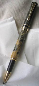

Being new to pen turning (I've made about 20 pens so far) i have progressed through the various pen finishing styles. Started with just sandpaper and worked up to MM. Next I got some HUT wax sticks (PPP) and used those with happy results. Then i got some HUT Crystal Coat and was even more impressed. But I was still not happy with the open grains. So after much reading in the shadows i worked up to CA/BLO and straight CA/Crystal Coat finishes. WOW, all great finishes and all thanks to you all on this forum. NOW FOR MY PROBLEM...I believe(?) I have a SERIOUS allergy to CA glues. I have talked directly with HUT and got the lowdown (MSDS and all) about their products. They guy said he hasn't heard of anyone with serious allergies to their fiction finishes. So that pointed me towards the glue and the wood species. All the pens (most likely removing the species question) that I have sealed with CA cause me serious breathing/congestion problems within 15 minutes of using or being near one of them. I don't know where to turn (haha) for an alternative finish that will give me the glass/sealed finish that CA gives. And although the plastic pens are nice, they don't give me the excitement of real wood worked to a beautiful finish. This got me to thinkng, coming from a model builders background, Future Acrylic Floor Polish is considered the Holy Grail of model makers 'secret' finishes. (both prefinish or final) Has anyone tried this finish on a pen? i was thinking of trying it to seal in the CA and protect me from it. Any feed back or alternatives would be appreacitated. Here is a picture of one of my favorites so far (pen #6) and it would be a shame to never be able to use it. :(

Additionally, I have an answer to my Future Floor Finish question. Although it make for an EXCELLENT glossy finish (it was originally developed by SC Johnson Wax as a linoleum floor coating), even appearing wet when fully dry, it doesn't seem to have a hard enough finish to be practical for pen use. ...unless you only intend to display them. I would still be interested to see if anyone would be willing to 'waste' a pen on this finish to see if they come to the same conclusion as i have.

For almost any substance there is usually a 20% of the population that has a sensitivity to it. That is why medicines cannot be prescribed then forgotten, reactions must be monitored. A cure for one is a killer for another. I don't doubt the CA sensitivity one bit, certainly possible. Too bad the picture doesn't show the pen finish better.

yeah, i just took a quick snapshot. i'll definitely work on the photography. no sense in making a beautiful pen if you can't show it off. maybe focus on that for awhile....keep me away from the garage!
