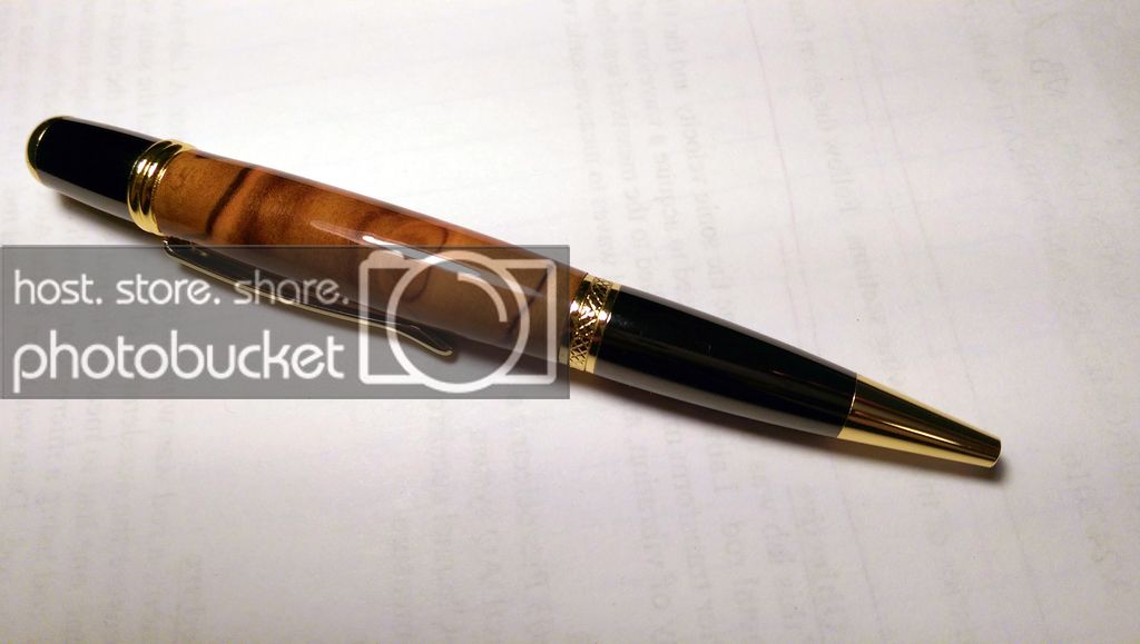

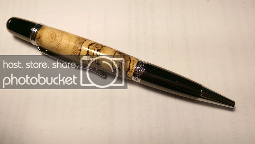

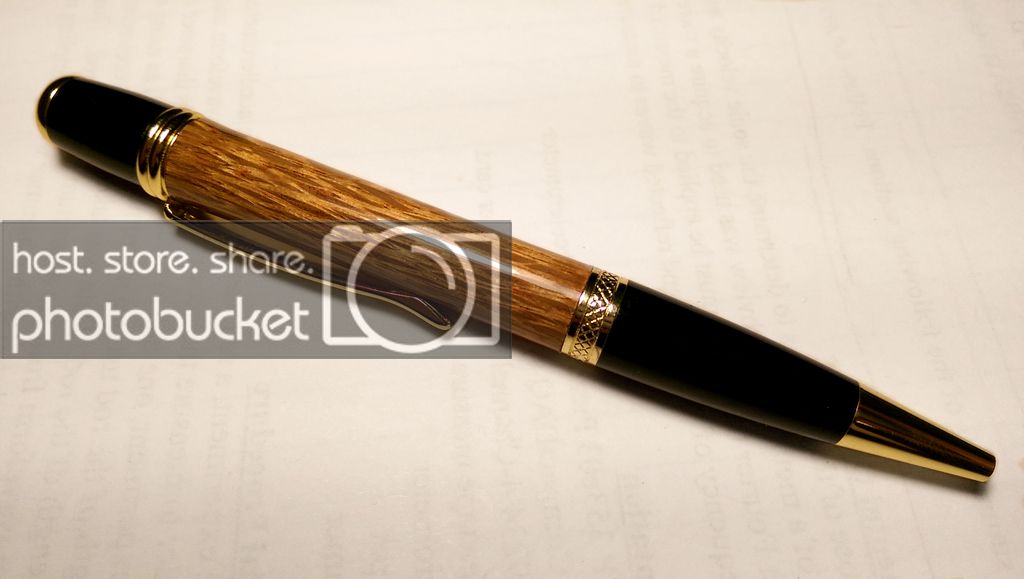

I got a chance to turn last Saturday thanks to some of the members here helping me find a lathe to use near Waco, where I'm currently residing. Here's what I was able to make:
Spalted Fruitless Pear
Spalted Hackberry
Lacewood

The finish is Mercury CA on all three. 3-4 coats thin and 4-5 coats medium applied directly from bottle, smoothed by blue shop paper towels. Sanded with 400-800 abranet, then the 9-step 1500-12000 grit Micro Mesh pads. I'm getting much better results with the 9-step (from the Classic Nib) than with the 6-step set (From PSI).

My abra net only goes to 500... Are you sanding between each coat of medium? Are you using an accelerator?
I noticed a big difference as well.
I got the starter set from Robert Kulp creations, it has 120, 180, 240, 320, 400, 600, and 800.
No sanding was done between coats.
Starbond aerosol accelerator was used for all except the first 1-2 coats, because they cure almost instantly.

Very nice but the salted Hackberry is my favorite
Thanks! It does have some beautiful lines. I have some magnolia that should turn out similarly, but a little darker tan, to try with my next batch next week.
