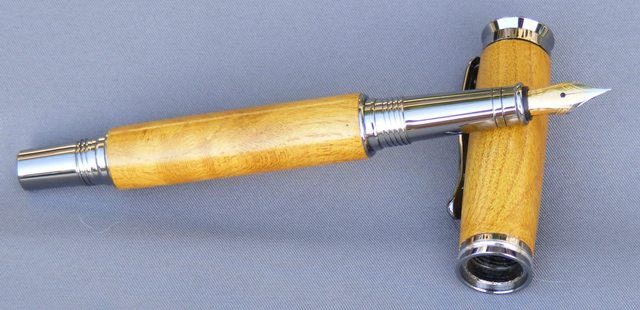

here is a Mulberry pen.
Turns beautifully
