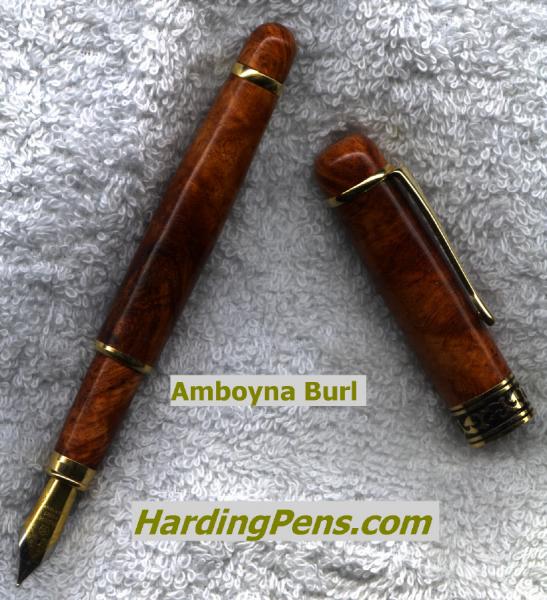

There are kits were the front section is wood. The Regency is one such kit.

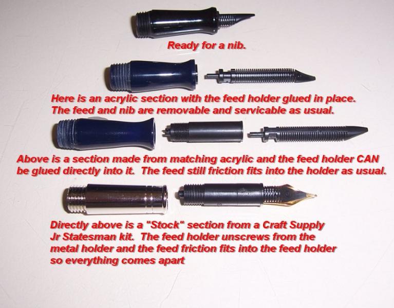

Not quite but you're on the right track. A nib feed goes into a feed holder. This feed holder can be glued in place. Below is a photo showing what I mean.
The taps mentioned for Lou's feed holders add a nice touch and I now use them myself but they aren't necessary.
Hope this helps a little.

Thanks George. That picture is exactly what I was thinking of doing. I just did not explain myself very well. As soon as I get my stuff from ED and Dawn I'm going to give this a try.

Good deal, I think photos often go a long way in describing something especially with fountain pens when we are using terms like nib, nib assembly, feed, feed holder, section, front section, section assembly, etc. If you need any more help, just hollar.

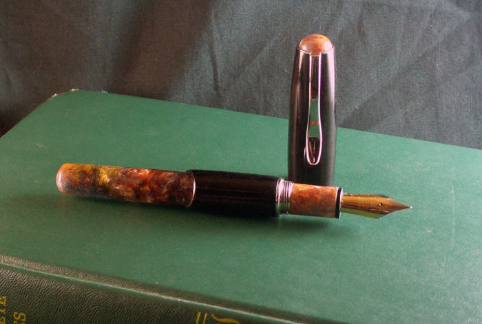

Also don't feel like you are constrained to the kit pieces. I just made a FP el grande, I too the grip, and turned it down and made a sleeve that would cover the component. I've done this with several different pieces. Another option is to look at the baron kits. The threads for the grip are seperate from the grips themselves, so you can turn the grip from any material and glue the thread into the grip.
That's a nice looking pen Ben. My goal is to be able to make completely kitless pens. The only part I want to have to buy is the nib and feed for fountains and the rollerball inserts.
