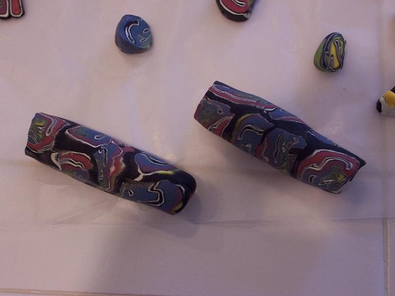

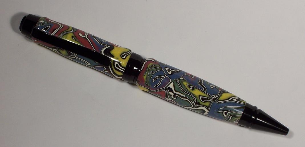

My first attempt at using polymer clay for pen blanks. These are both from the same batch of clay, my "Fried Brain" series. Both with a CA finish. I thought they turned out pretty cool (photo needs some work). What do you guys think?

This was Sculpey III, I think it is basically the same as Fimo. I covered the brass tubes with the clay then baked them, so no need to drill them, just trim and go. I used a spindle gouge and skew. They turned nicely. finished them off with CA.

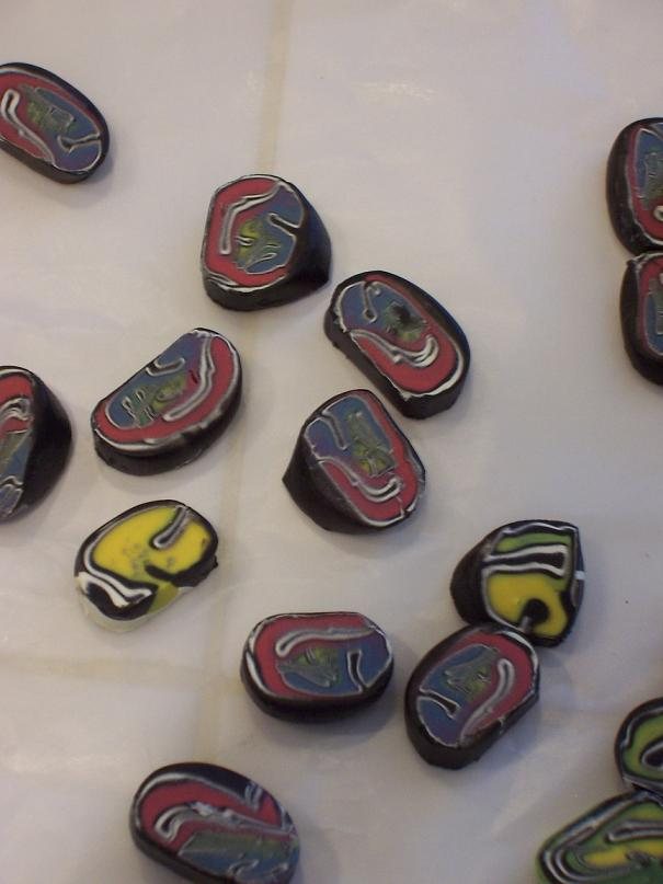

I got the clay from Michael's. I did some research online to figure out some cool designs. The pieces were made from a "cane". The design did not turn out as intended, but the result was good none the less.

I googled polymer clay. I found the following site useful. (http://www.polymerclaycentral.com/masterindex.html). Under the topic of Canework you will find techniques and designs. basically you make a long roll "cane" which contains your design and you cut slices from it and press them onto to the brass tubes (no glue or prep) and press them togetther to fill the gaps. pop the blanks in the regular oven on a piece of foil for 15 minute (per 1/4 inch or 6mm thickness) at 275 F (130 C). I put mine in for about 17 minutes. When the come out of the oven they are still a little soft. Let hem cool and they are ready to trim and turn. I wet sand with mm up to 12000 and finish with CA. I did not take picture while making these. Next batch I'll take picture along the way. Let me know if you have any more questions. I made two pens start (open pkg of clay) to finsh (showing off to my wife)in one evening.
