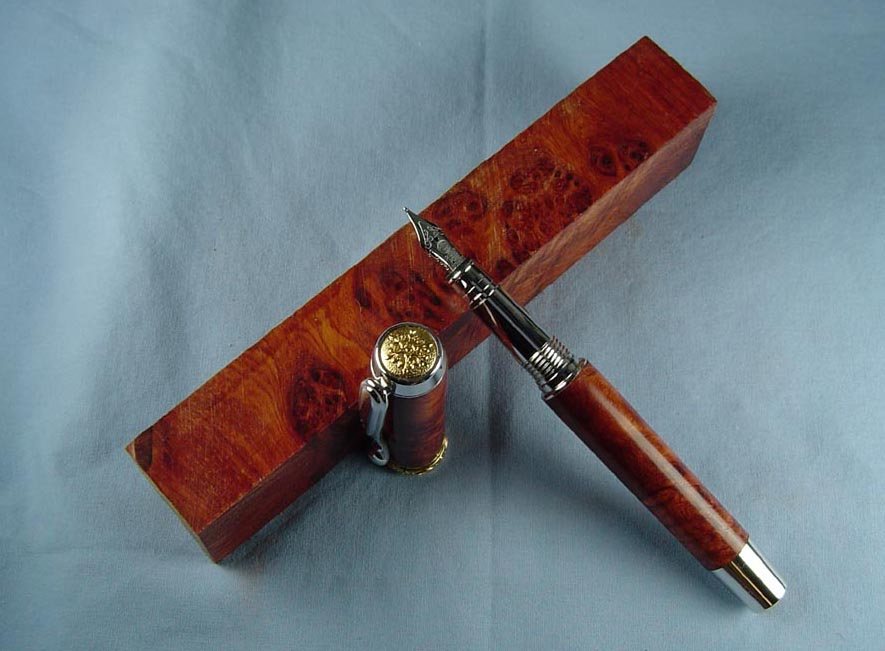

This is the Jr Statesman i posted in the show off section, bunch more pic there.
I’ve been trying different shellac type finishes. I like this the best so far. I like the look, has depth to it and feels like a highly polished table top, or guitar.
Its Zinsser Bulls Eye French Polish. I applied it with cheesecloth. I picked it up at my local rockler store.
http://zinsser.com/product_detail.asp?ProductID=87
Its not the real method of applying a french polish finish.

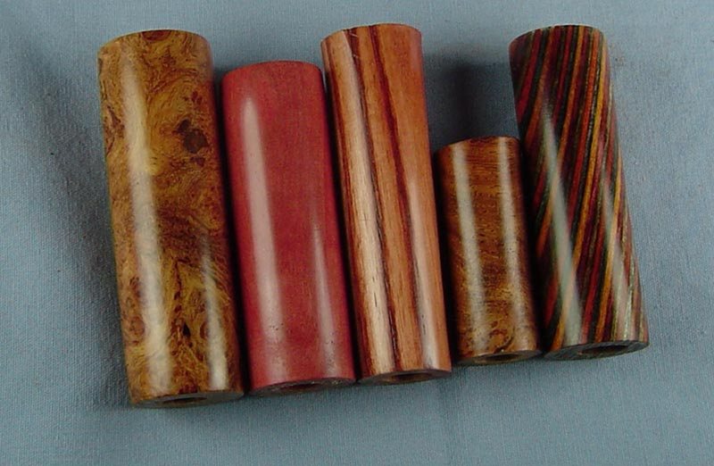

I put a coat on and let it dry for about 10min, used cheesecloth to smooth it out. Put pressure on like you would use friction polish, you’ll see some finish on the cloth. You can watch the shine run up the pen did that about 3 or 4 times I guess.
After it dried a while , I started to assemble the pen. Put the wrong piece on the end so I had to disassemble the body. Wrapped cloth around body, put in tool and started hitting end until it came out. I didn’t think the finish was cured enough and I was worried that I had messed it up. To my surprise it handled the pounding well no marks at all.
This is just the finish no wax. Want to see how it holds up. I think to protect it and give it a little more luster ill try using a paste wax. I think it really looks and feels nice.
I was worried that it would chip, so i dropped it a few times, and hit it lighty. Held up nice. Dropped the blank NOT the pen lol.
Even put a little on the block of wood as well.
I put only one or two coats on these pieces, to test.
Im going to put carry them in my pants pocket this week, to see how they’ll hold up.
From left to right, amboyna burl, pink ivory,tulipwood,Afzalia Burl
burl, diamond wood. The bottom of the pink ivory and the diamond i
smuged up a little.
thanks..pete

Well my unofficial official test results are in.
I would post pictures of what i carried in my pocket all week.
But they look the same as the ones here. Held up great still shiny, no scratches.
The Jr held up as well. all in all i really like this finish.

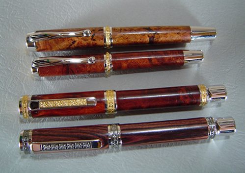

These are my test finish pens.
First is no finish used about three months,
applied furniture polish once week
Next two are 2-3 weeks old 2-3 coats shallac
Last is the one i just did, tung oil with 5 coats finish, and hut wax.
Wiped them with rag before i took picture.

Originally posted by challagan
<br />Pete, which is the Tung Oil finish one, the top one in the photo or the bottom one? Great looking pens. Curious on how that tung oil finish holds up as well.
corey
Corey
Its the bottom one. The emperor made from kingwood. Its not strictly tung oil. I put a couple of coats of oil on after i sanded. Then put the coats of shallac on over it. I tried just tung oil a while back but didnt like the way it came out. Of course i didnt put it on like i would a piece of furniture. Coat on let dry sand, coat on let dry sand....etc It would take days to do it right(accourding to the book)
Im still experimenting with these finishes, but so far this last one seems to be working well. It has a nice woodsy feel to it.
If i confused you more ask away....pete
