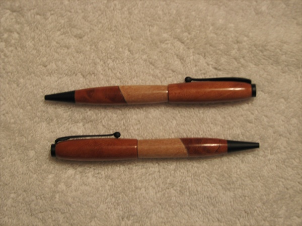

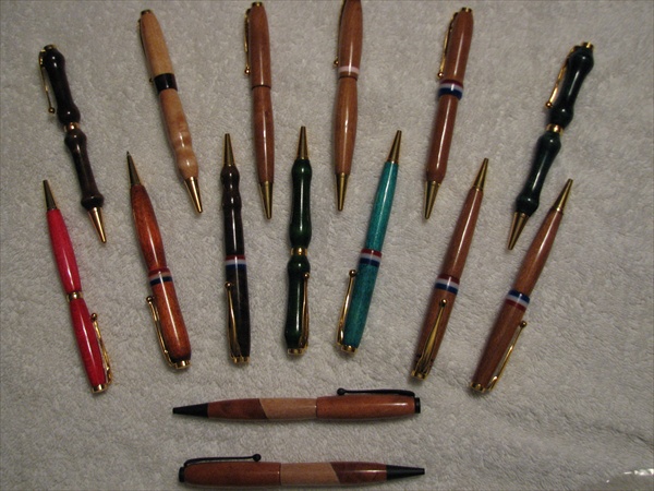

finishing up a load of freedom pens, had a ball with it, trying new stuff. the red, white and blue center bands i think turned out well. they are colored plexiglass which cut into 3/4" strips, glued up, then cross cut into 3/4" squares. found you have to drill the tube hole from both sides, big time chip out in plexiglass.
real happy with my first attempts at segmenting. the pix probably isn't good enough to show that there is a piece of soda can between the two woods on the bottom barrels. looks great in your hand.
thanx for looking, comments welcome
Sulli
p.s. the colored ones are done with sharpie markers after sanding, worked great on lighter colors, darker clorors get blochie- thanks Capt Eddie on youtube.
