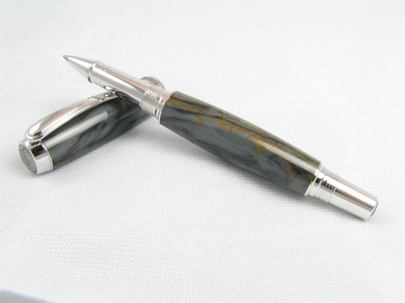

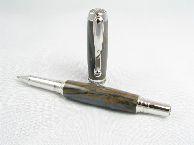

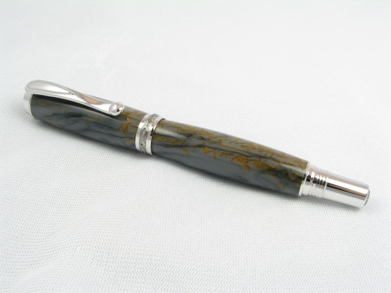

Opened my latest shipment from Exotics and low and behold, there was a piece of Bakelite that I had not ordered with a note from Dawn explaining that this particular piece had a crack in it and, in essence, challenged me to turn it. This particular piece had a crack that ran the entire length of the blank and went exactly half way through. Of course when I drilled it for the tubes, it split open, so I cleaned up the crack some (that doesn't sound good I know, but I can't think of what else to call it :biggrin:) used some medium CA to bond it together and put clamps on it. Reverse painted the holes black, and turned very carefully with super sharp tools and here is the result. I think that considering this bakelite blank is probably somewhere around 70-80 years old, that it's perfectly acceptable to have some cracks in it. The main one runs the lenth of the pen and there are tons of little tiny hairline cracks that run off of. I think it has that antique look to it and the Jr. Statesman is the perfect compliment to show it off. It may not be for everyone, but I like the way it turned out.
By the way, I'll gladly take any freebies I can get! :biggrin:
Comments welcome, both good and bad...

You really met the challenge and created something unique! Super recovery and beautiful pen! Dawn and Ed are great about freebies and Bakelite is a rarity. Regards, Doc

Nice pen!! I have a piece of cracked bakelite that I was really upset about when recieving it, now I realize there is hope.
David, what a masterful job!
I had never come across a piece of bakelite with that black and gray color, and my heart sunk when we cut it and saw the cracks. I knew that saving it wasn't going to be easy...it if could be done at all! But, you really rose to the occasion!!! :biggrin: :cool:
Amazing David!! And now you have an unusual and beautiful pen with a bit of history. Gosh I love it when all of the pieces come together!!:tongue::biggrin:
Way to go, David, you took what to many would have been just another piece of trash and turned it into a work of art. Congratulations.

Thanks Dawn! I'm really happy with how it turned out, I like the uniqueness of it. It was a fun challenge for me!
