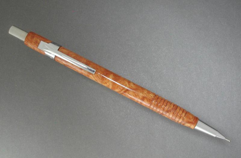

Got on a roll and ended up with nine of these.
Today. I found this blank in my tool box and had to see what was inside. Its Koa.

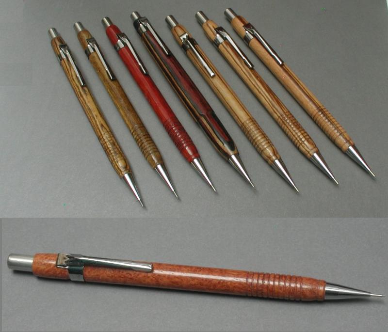

Yesterday. Filled an order for seven pens. Since this makes over thirty this customer has ordered I threw in a freebie.
From Left. First two Bocote, Third from left Bloodwood, Middle is the freebie in Pakkawood, Three on the right Zebrawood
Bottom of photo: Afzilia Xylay

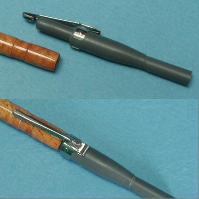

Jerry,
I use an assembly tool. One end of the tool is turned to fit into the barrel. The other end has a taper turned on it with a step to end that fits into the barrel. I slide the clip on the tool then onto the barrel. I get a picture of the assembly tool tommorrow.

Anyway, here is a photo of the assembly tool.
<br />
Chuckie
That's very clever Chuckie, maybe I just don't see it in the picture does it also slide over the barrel to just above the groove you have cut for the clip protecting that 1/2" or so from the top of the barrel to the groove?
This one does not over lap the end. The shoulder is slightly wider than the pen barrel and so far once the clip is started pushing it the rest of the way to the groove has not caused damage to the finish.
