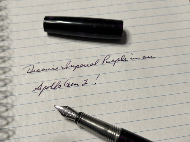

@rixstix
You might want to consider swapping out the section and the nib with a section and nib from another Apollo gen2 kit.
I inked up my gen 2 Apollo, and it's writing just fine. I grabbed another kit and tested the parts for air tightness, and everything seemed to be nice and tight. (I was concerned about the triple start threads...)
Here are my 2 Apollo's... Gen 2 on top, Gen 1 on the bottom
Medium point Schmidt nib, writes just fine!

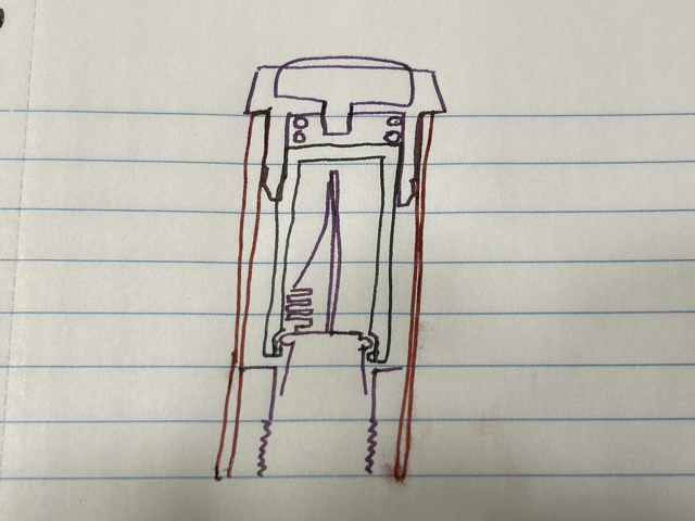

I am sitting here staring at a Baron Fountain Pen. I sure would like to make it a little more air tight...
I am debating if I can make an inner cap that fits over the nib. I would have to slide it into the outer cap before I press in the other components.

Okay so here is the inside cap idea for the Baron Fountain Pen... it's a little rough, hoping you can see what I am thinking... your thoughts?
As discussed above, my experience is that fountain pens with slip on caps tend to dry out faster than those with screw on caps. But in addition, my experience with kit fountain pens with slip on caps is that the device inside the cap that snaps onto the section is a source of great frustration when assembling the pen.
The first problem is installing the snap cap. In most kits, the device is supposed to thread onto a male stud on the bottom of the top finial. The hole in the snap cap that goes onto that thread is unthreaded, and the material is a hard a hard plastic that doesn't want to thread easily. The instructions that come with the pen suggest inserting a No. 2 Phillips screwdriver into the bottom of the device (where the section normally goes), and using that to rotate the plastic bit onto the threaded stud. My experience is that that approach just doesn't work very well. The plastic material is too hard, and the end of the screwdriver doesn't grip the plastic; so instead of driving the unthreaded female portion onto the threaded male portion, the screwdrive simply rotates inside the plastic shell. I've found that a Torx screwdriver works marginally better. Better yet, sacrifice a cheap Harbor Freight phillips screwdrive by grinding the nose off so that there are four sharp corners. But the best solution is to carefully measure the threading of that stud, and then use a machinist's tap to cut real threads on the female portion of the plastic gadget. But the problem that creates is that if the threads are too loose, the snap cap will quickly become loose as the cap is removed and replaced. Adding a drop of thick CA (or Loctite) may solve that problem, but its important to not use too much.
And then there is the matter of getting the snap cap aligned so that the cap and body are spaced properly when the section snaps in place. If the snap cap is installed dry (with no thread locker), it may be possible to rotate the body to advance or withdraw the snap cap enough to get the desired spacing, but if CA or locktite are used to lock the threads, that's difficult.
Finally, I've been known to totally destroy a plastic snap device when trying to install it inside the finished cap of a pen. Bad words were said! Some pen kit vendors have spare parts, but that means another order, and waiting another week before completing the assembly. GRRRRRRR.

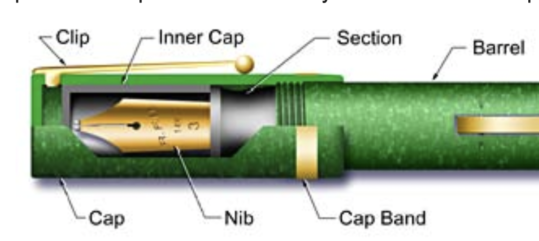

This article was written by Richard Binder who was one of the best known fountain pen repair persons in North America. Here's a link to a National Geographic video about him:
The drawing depicts a typical lever-filling fountain pen. For years, this was the most common design from the invention of transportable fountain pens until it was replaced by cartridges and converters. Ink was contained in a rubber sac inside the barrel; to fill the pen, one would pull back on a lever to force a metal plate to squeeze the sac, and when the lever was released, the resulting vacuum would draw ink through the nib and into the sac. One of the shortcomings of the design was that the rubber used to make the sac would dry out and crack, and much of Binder's work involved replacing old sacs. There aren't many lever fillers being made any more, but you will see many of them in pen show collections. I presume that some of them may have the inner cap arrangement show in the sketch, but its not possible to know for sure without disassembling the cap. However, I do know that none of the screw-cap fountain pens currently residing on my desk has an inner cap.
The text accompanying the image includes this description: "The inner cap, also shown cut away, is pressed permanently into the cap, and the lip of the inner cap mates with the flat face of the section to form an airtight seal when the cap is screwed on tightly." That means that the air seal was created when the end of the inner cap was pressed against the face of the section as the cap was screwed onto the body. However, the potential weakness of this arrangement is that it relies on the two mating surfaces being absolutely flat, and on the cap threads assuring that they are perfectly parallel so that they seal tightly against each other.
I would think another way to accomplish the same effect would be to incorporate a rubber o-ring in the seal. However, o-rings periodically need to be replaced, and that introduces a new set of problems.
Snap cap pens have a semi-flexible plastic inner cap that works by capturing a ridge at the end of the section in a recess inside the cap. That works well as a way to hold the cap onto the body, but because the ridge is only loosely held in the recess, it's not airtight. Screw cap pens can seal better than snap-caps, but require that the cap be screwed onto the body, and if the cap isn't tightened enough, the seal won't be effective, and also the cap can work its way off the body. The Japanese pen manufacturer Platinum uses a patented 'slip and seal' design that supposedly overcomes the shortcomings of both snap can and screw-cap designs.; this design appears to employ a spring inside the cap to maintain pressure on the mating surfaces of the air seal.
