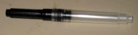

Is this the coverter pump?
<br />
If so my jr gent, from the Group buy at the pen shop came with it. If not, What the heck is it ?
Originally posted by dbriski
<br />Is this the coverter pump?
<br />
It is the converter pump, just recommend a good ink, like the Private Reserve, Noodlers or similar ones. BTW, I have a colleague who exclusively writes with fountain pens, and he uses the converter pumps when he is not traveling. As soon as he travels in a plane, he changes to cartridges. He takes the pen empty (!) and some cartridges to the trip and puts them in after he has landed - from his (and own)experience I can not recommend to use the pump when traveling.
