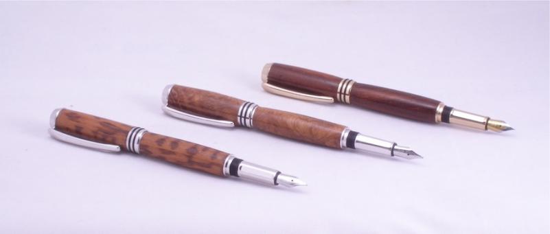

The Tycoon from PSI is a favorite of mine. The gold plating is epoxied and guaranteed for life. It's a relatively slim version and quite good looking, I think.
