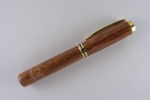

Hi All,
This closed end Jr. Gent fought me all day and it never did came around. I wound up sanding the finish off twice and never could get it right. I've never had so much trouble with a CA finish. Actually CA/BLO. The wood is Bubinga. You can see the trouble spot, near the end of the lower barrel. The first time I just screwed up the application. So I took it off (to the wood) and tried again. The next one was better, until I tried to put on Ren wax. The CA turned almost completely white. ?????? So one more time, sanded a little and just sprayed on clear poly. And the white spot still showed through where you see. I pretty much gave up. By the third time, I was in jeopardy of under sanding it. The upper barrel is already close to being under the CB.
Oh, and then theres the fact that I haven't seen a tutorial on turning a closed end cap style pen. Duh. I felt like a dumb-ass.
So, long story short, (I know, too late) I screwed the pooch big time on this one.
I guess we need to foul one up once in a while to keep things in perspective.
By the way, does anyone know where to find a tutorial on closed end Gents? If I have to, I will go to AS, but I'd rather not. No offense Bruce but money is not plentiful these days. The mandrel buy was my splurge for this month.
Any ideas as to what went wrong on the finish end? The wood, the CA/BLO combo or just the dumb-ass applying it?[B)][B)]:(:(

One thing you might try, is to buff the end of that pen with some white diamond, or possibly just with some wax of some kind. Not so much to change the surface shine, but to generate some heat that will penetrate under the top layers of the finish and possibly finish the cure of the layers that are cloudy. I have had this fix some problems with cloudy spots, and some others I buffed right through the finish without having the cloudy parts go away. You never know, but the good think is you can try it without having to change anything, or even disassemble the pen. just don't buff onto the metal parts if it's a gold kit. DAMHIKT!
One observation, is that the worst of the fogging seems to be about where the end of the tube would be inside the blank. It could be some kind of reaction through the wood between the finish on the outside and the glue on the inside holding the tube in. Stranger things have been known to happen.

I see this as an internal problem rather than something you did with the CA glue on the outside.
This is what the wood looks like when it gets very thin, and just before you break throuh. You are looking at whatever is inside of the hole from the other side. That sharp line suggests that the end of the tube is very close to the surface. It also suggests that the drill got too hot while drilling the hole.
Thanks Russ. It's a relief to know that it's not totally because of the finish. I was doing so well with the CA/BLO. Now it will be easier the next time I use it. I wont be questioning myself.
