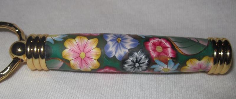

The first pics is the completed keychain. No finish, just sanded.

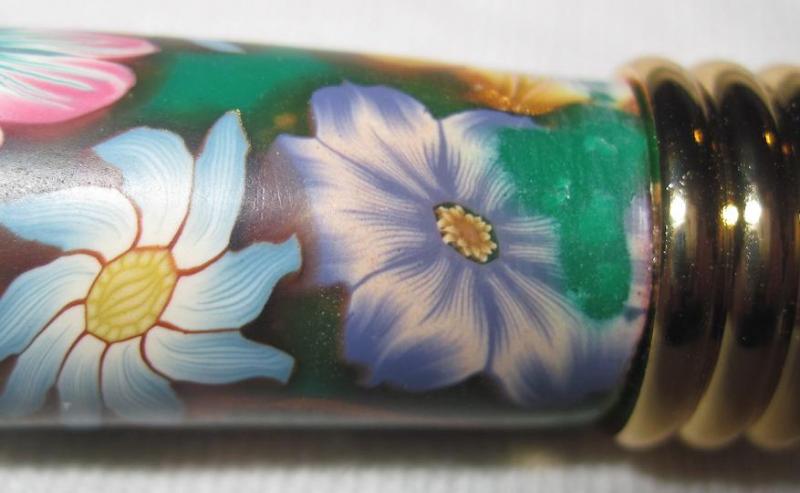

The second pic shows where i turned it too low and got into the base clay.

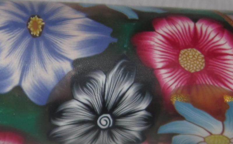

The third picture is just to try to show off the amazing detail in Toni's canes.
