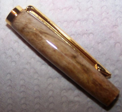

Still Working on the CA finish. I got a box of shorts from Victor (LandfillLumber) and I thought this was a beautiful piece of spalted sweet gum. Thanks Victor for the sweet gum and Jim for the video

I bought a box of 30 pen kits (actually Jim threw in a few extras…thank you) and have been practicing the CA finish in the video.
This is attempt #13 and in my opinion is a definite improvement. I only have a picture of the top half cause the bottom didn't come out so well I'm embarrassed to say.
It's still no where near a lot of pens I have seen on here, but I'm still practicing.

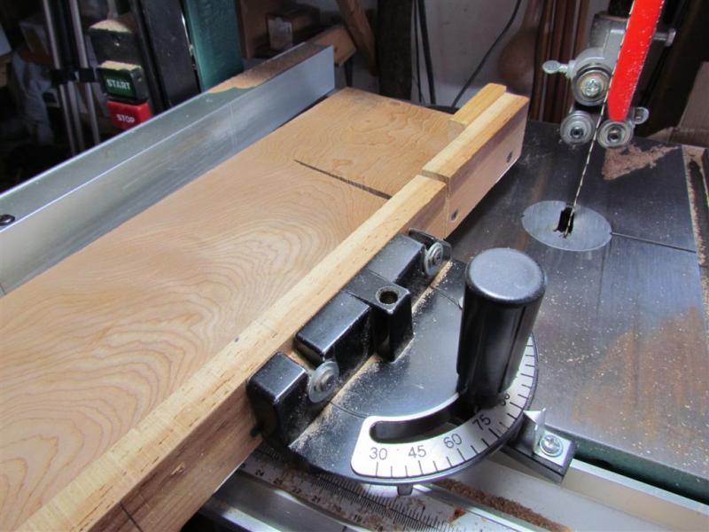

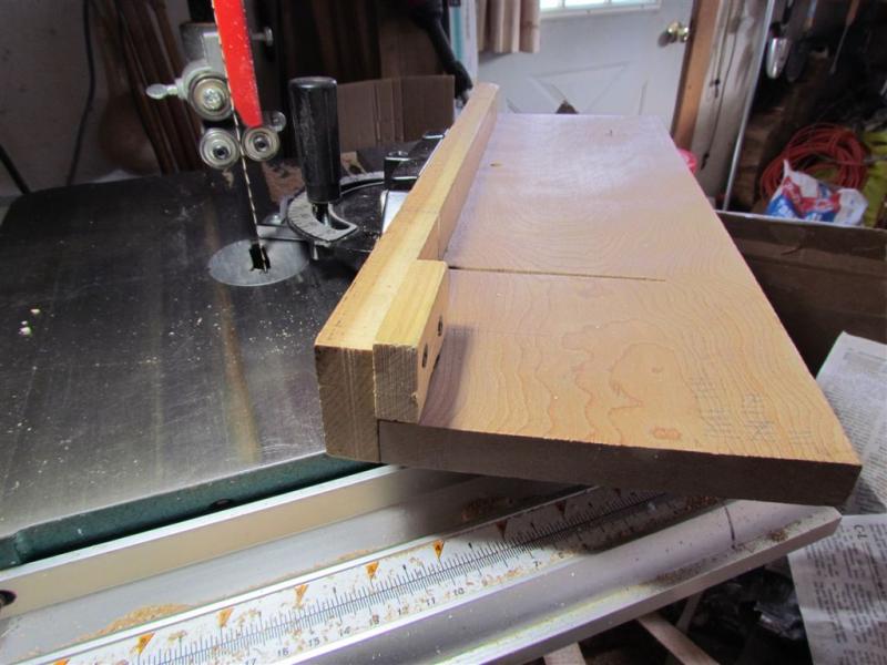

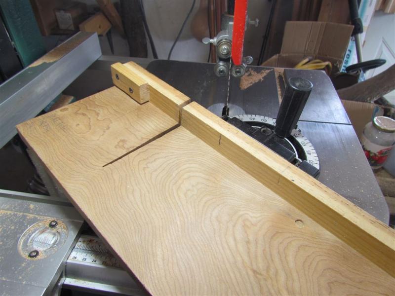

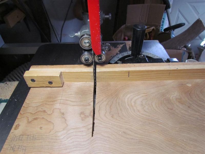

This is 4 short video clips on cutting pen blanks with a simple pen sled.

1. How can I build a pen sled like the one you use for the band saw?

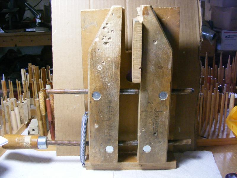

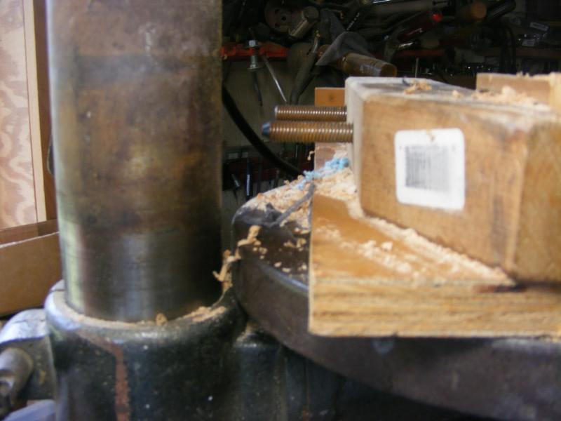

I used the steps in the video on how to drill the blanks. I got a wood vice / clamp like you had. Between doing that and the tips that renowb gave me I have not wasted so much wood.

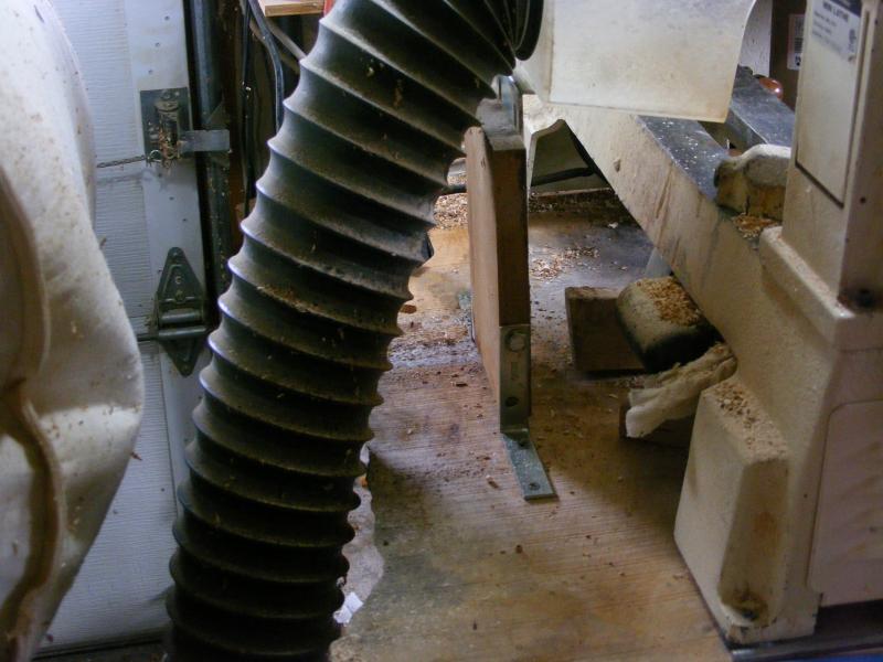

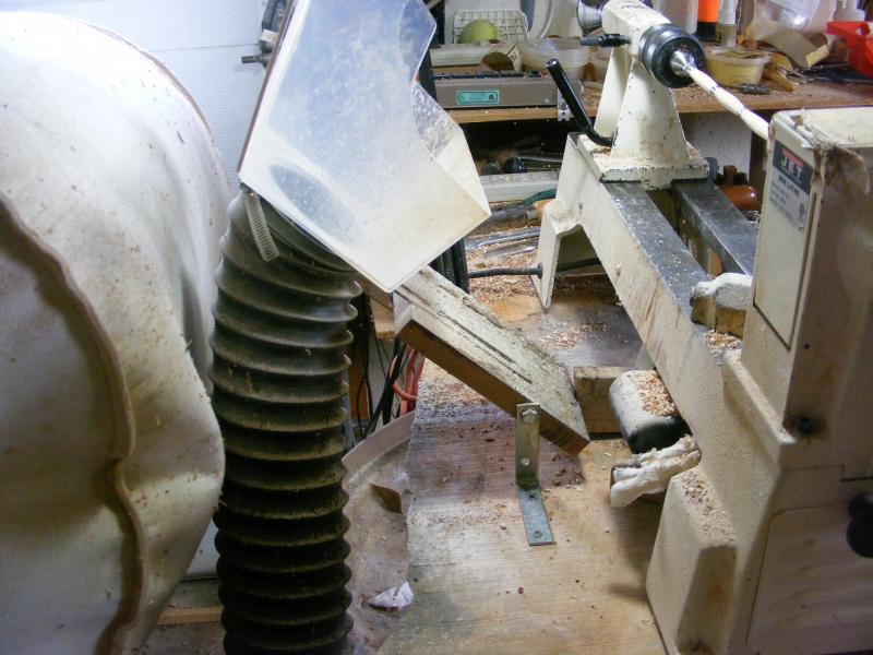

I added two photos of my dust collector bracket
Pen Sled
photos
