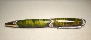

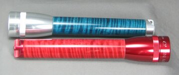

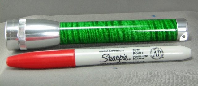

If done ALOT of pens this way and in my opinion Curly Maple is the best type wood to use. Here's a few MagLites done this way in Curly Maple........

I use a CA finish on top and have never had any problems. BUT.... if you sand your CA finish be careful not to sand through or you'll get a white spot and you'll have to remove everything and start over. The color doesn't penetrate very deep so it's real easy to sand through it.:wink:
