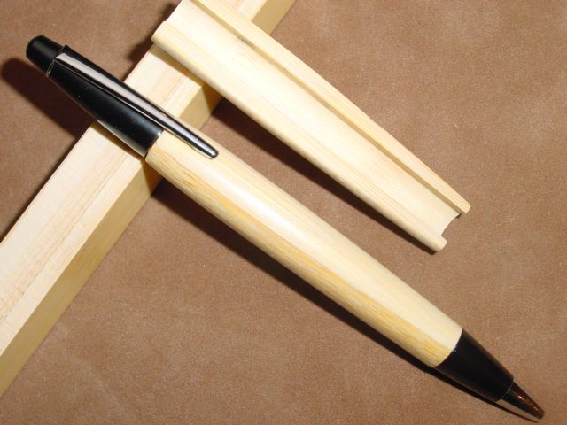

This is some materail I was playing around with that came from Bill. He has had it over 2 years and hasn't cut any yet, so I thought I would show him what he has. At first glance, it may seem kinda plane jane or has that modern euro look to it. But what you can't see, is the nice texture to this pen. It is made out of bamboo and has a nice hard feeling to it, with the ridges of the bamboo. This was cut from 3/4 T&G flooring that looks like solid bamboo, but there is a laminate in the middle which looks to bamboo also. Anyway, thanks Bill for the unussual stuff. [:p]

Nice looking pen Anthony, (although I could have sworn it looked like a shaving brush there for a minute or two :)[:)]
...nice looking wood also...did you have to do anything special to turn it...someone gave me a piece of their T&G bamboo flooring and wanted a pen from it but I kept tearing it...yours looks good though..![:)][:)]
Tearing it [?] You mean like the sample next to it [:D]
I turned these without the tube glued because I wasn't sure how I would like it. I had to put a little CA at the laminate joint, but other than that, no problem on the first one. The secound one, I caught a snag at that joint before I got to the CA and snapped it in half. Had it been glued to the tube who knows what would have happened.

Anthony, I like it because it's unique, but I don't really like that style of pen. Will you be making any more? And I'm not trying to get even with you either. [:D] I'm being honest, lets just say the jury's still out on this one until you make it with a different pen style. You'll do that for me, right? [:D]

The Wall Street was not my first choice. I wanted to do a Baron,
But I may have exagerated on the thickness. I don't think there is
enough material there to drill. After I turned it, I still had thoughts
about putting it together, but I really like the feel of it better
than the look of it.
Thanks for your opinion, and NO I am not going to make you another [}:)]
