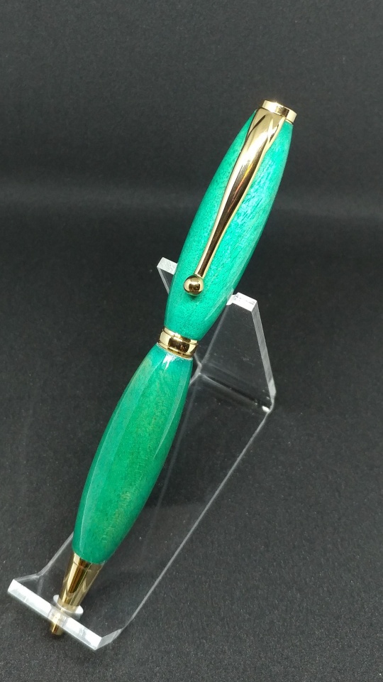

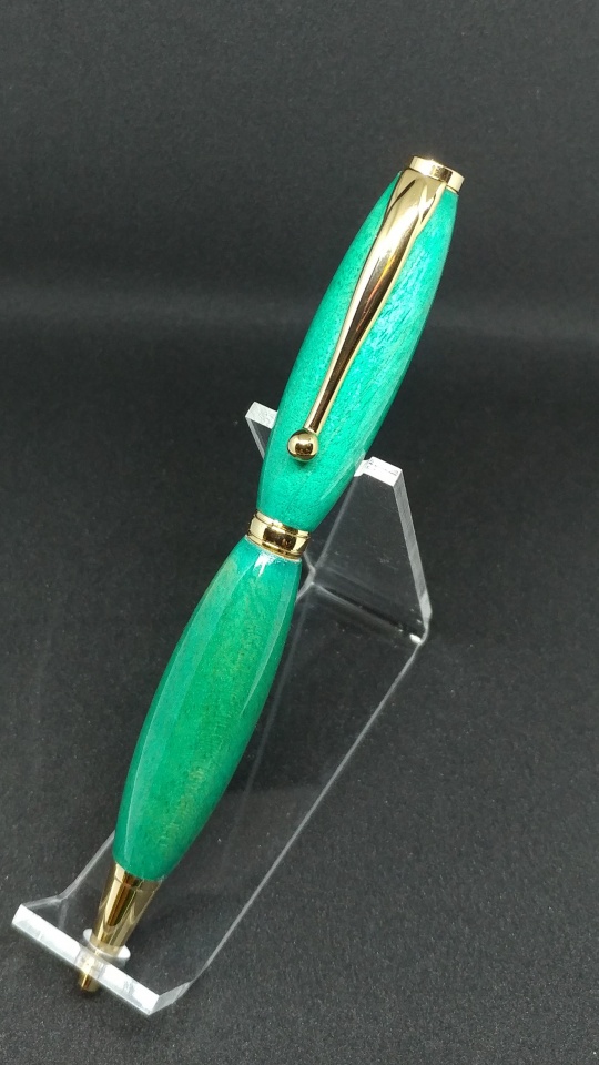

First try with that dye. Really happy of the result!
We dont see it on the picture, but I inserted the transmission to deep in the tube, so I will not be able to sell it, because the tip goes to far when we turn the pen... I'm still Learning...
What wood did you use ? . I really like the final color !!!!
Thanks! I'm surprise about the colour. I bought it as a test colour, but I'll make some other pens with it. :)
I used Maple (Blank made from a kitchen table leg that someone wanted to throw away... I made few scrollsaw puzzles with the table top and pen blanks with the legs...)
