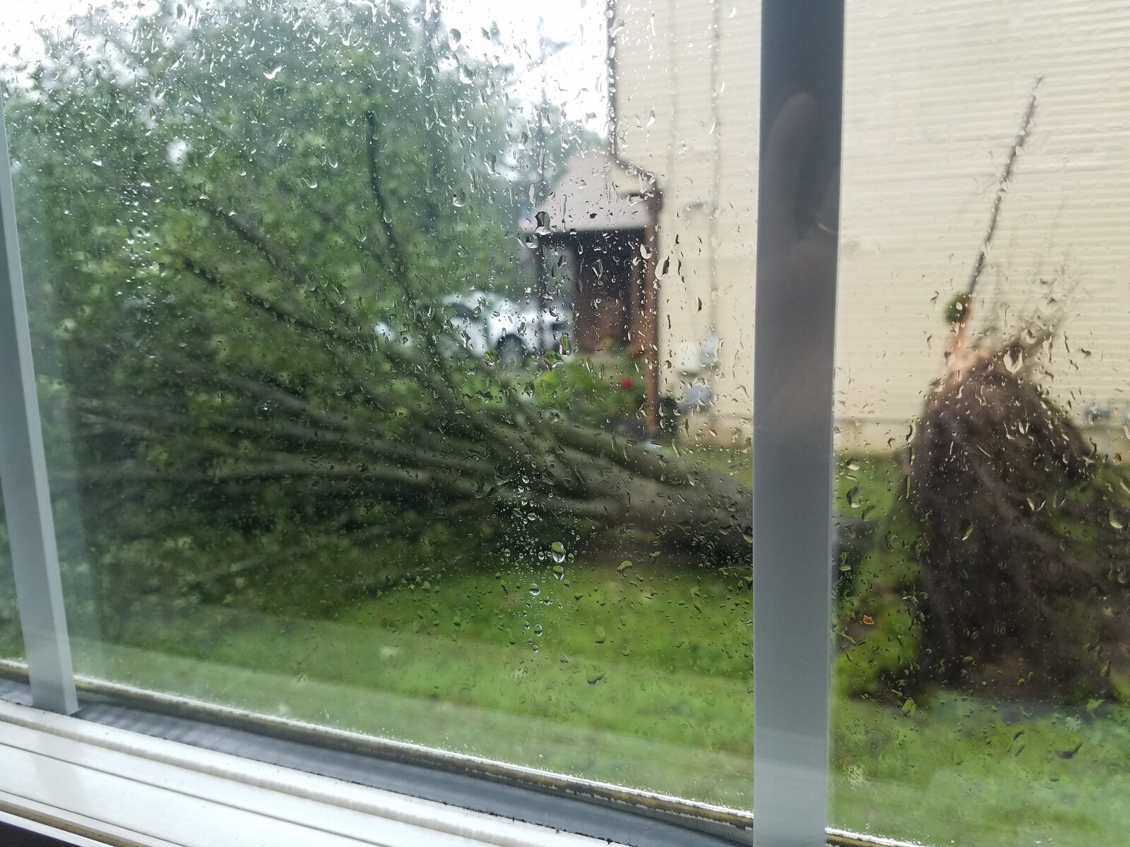

So the hurricane (well, it was a tropical storm by the time it got to us) blew through today and trashed my neighbor's flowering pear.

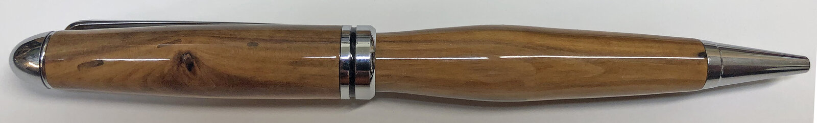

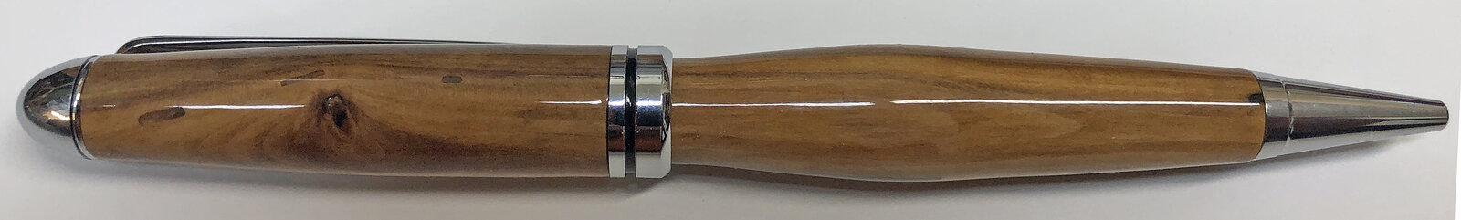

I salvaged some from a tree in my yard here in Nebraska about a year ago (winter storm damaged). I've made a couple of pens with it, and they are pretty plain, but I tried to pick out pieces that had some darker areas and more interesting grain, small knots and such.
I have heard that the wood likes to crack when it is drying. I let my logs dry in the house for about a year before cutting them into blanks, and upon checking I find that some of the blanks appear to have cracks on the ends that I don't think were there when I originally cut them, so if you cut it before drying you might want to oversize things.
More than anything I did it for the sentimental novelty of having pens made from wood that came from my yard.

PS Here is a picture of one of them - worm holes and all.

PS Here is a picture of one of them - worm holes and all.View attachment 243536
Well the top is interesting. I was surprised by the color of the wood. I'm going to grab a few logs that would fit into my band saw and let them sit in my basement for a year. Or, maybe I'll cut one, and leave the other sit. Just to see if there's a difference.
