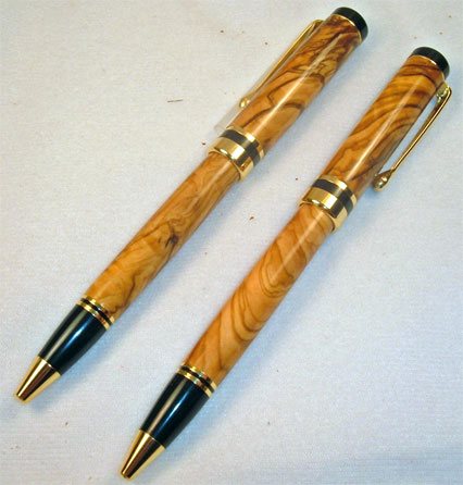

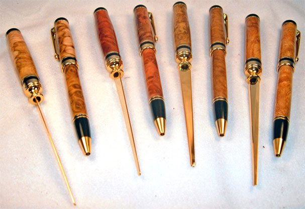

These are a buch of flat tops I finished up today.
these are York Gum, Red Malle, Brown Malle, Afazellia
These BOW Burl.

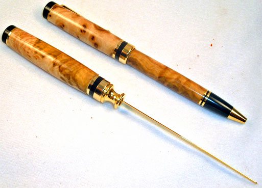

close up of the York Gum. Awsome wood.
