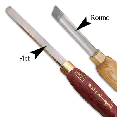

Just to be clear, this picture shows the surface area I'm asking about:

The tools you show are a round nose scraper and an oval skew. The arrow is pointing to the bottom of the scraper and that is the side that rides on the tool rest when in use and yes it does need to be flat when in use. I don't think that many, if any, turners round the corners of the scraper.
The narrow edge of the oval skew is intended to ride the tool rest. I often use an old skew as a scraper to level out the highs and lows, and I think that jskeen's idea about shaping it like a 7 instead of the standard > is a good one. I used the oval scraper almost exclusively for the first few years I turned pens, then I came here and read about turners having love affairs with their skews. Now I'm almost exclusively a skew user. Learn to use it, you might be very happy that you did.

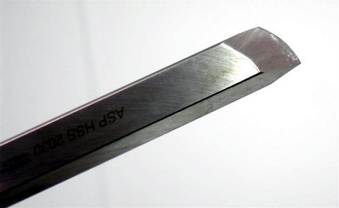

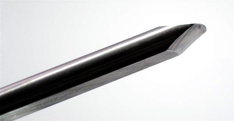

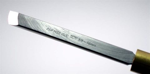

Skew profile, Tool Rest
Here are pictures of an Alan Lacer skew, straight from him before I turned a blank. Notice how he designed it with a curved bottom and a flat top, and the curved profile.
The curved bottom edge is usually the surface riding the tool rest, and there are no edges to catch. The top is flat because it's meant to be turned over and rested on the tool rest for slicing directly into the blank for straight lines.

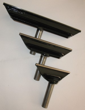

The 6" Comfort Tool rest is something I just ordered and should receive this week. The picture shows their 9", 6", and 4" versions. It has a stainless steel rod epoxied at the top, and should prove practically nickless and catch-free.
From the website: "Our original Comfort Rest, Low Profile Rest and Mini Rest feature a 1/4" hardened steel rod on the top surface that provides a smooth surface that won't nick, ding or ever need filing.
The hardened rod is epoxy bedded and is fully guaranteed. If a rod ever comes loose, we'll repair or exchange your damaged rest at no charge."
The 6" is $49.
