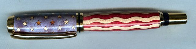

Only the second one I have turned, but the last one sold before I got a pic, so here goes.
Flag pen blanks can be purchased from http://www.kallenshaanwoods.com/Store.asp?m=Kallenshaan1&n=14&k=4652&s=Stars+and+Stripes+Inlay+Kit . The price is $45 and Ken stocks them for the Jr. Gentleman, Gentleman and Baron kits.
Ed, I have looked at that a couple of time and have always thought of doing one... how tricky is it to do... I realize you need to glue to stars and stripes in place... did you use CA or something else.. and did you have any problems turning it when they were in place...
Thanks... pen looks great...
Griz,
Only here would I tell the truth-the first pen of this type I turned completely with my 60 grit gouge (a term I learned here)!
This is the second one, I got braver!!
First, the kit comes with GREAT instructions-water down some yellow glue and use that to affix stars and stripes. I only do one stripe per night and clamp it for 24 hours before doing the next. The glue actually makes the inserts (stars and stripes) fit. Again, the instructions say don't try to dry fit-it won't work. In the strains of an old song, "you gotta have faith my friend..."
When the blank is finished, the stars, particularly, seem like a bunch of edges waiting to catch. So, this time, I really sharpened a skew (with which I am most comfortable) and set to work SLOWLY. Lathe turning fast, but taking off a _____ hair at a time. (read very small hair)
As the work progressed, it became like turning any other wood. In short, I would NOT recommend it as an early turning project but certainly half the people here CAN do it. (The other half can too-just stick with the 60 grit gouge.)
Importantly, the kit is $45 so my fear factor was high! But, the first one I made (my other half bought-I didn't know what it cost), sold the first time I let it out in public. It (Gents pen) sold for $135 (I think she would have paid over $200, but the price was marked inside the box). She went ape when she found out there were really 50 stars and 13 stripes.
Griz, you should try at least ONE. You will have a great time making it. I have a Jr. Gent glued up also, but if you decide to try it first, make sure the trifocals are working-THEM IS SMALL STARS!!!!

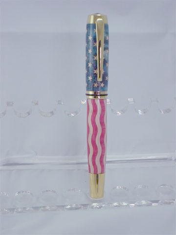

So if I wanted to do a Statesman I could order the Gentlemens kit? I think these would be great! What kind of price do most of you put on them, $150, $175? Great looking pens , by the way, Lou and Ed!
Turning the pen is no harder than turning a regular blank, except it is a $45 one instead of $5 and my mind played psychological tricks on me.. It will turn just fine if Ken's instructions are followed to glue in the pieces. The stars are easy, but the stripes were my downfall, until I yielded to Ken's lead.

If you do a statesman, you have $80ish in it! Admittedly, it still takes the same amount of time to turn as any other pen, but it takes a week (half hour a night) to assemble. In my mind, that makes it a $200+ pen. Small market. Gents pen can stay in the $150-180 category-larger market.
NO GUTS, NO GLORY-but I chickened out and made a gents. Last one, as I said, sold the first time it was exposed to humanity-gents pen-$135 (the blank was given to me by my better half who did not tell me the cost, just said it was a $100+ pen).
In short, the kit is great, the pen is cool, the market for the pen is limited (NOT NON-EXISTANT, JUST LIMITED).
