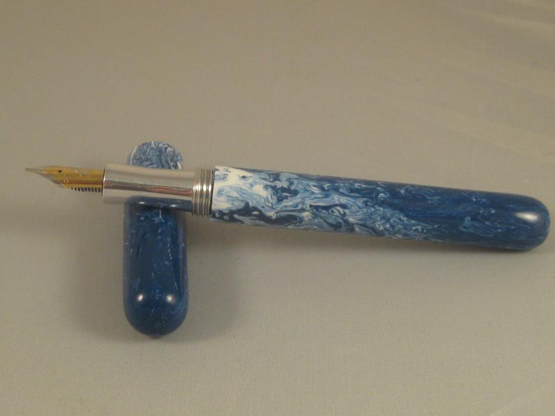

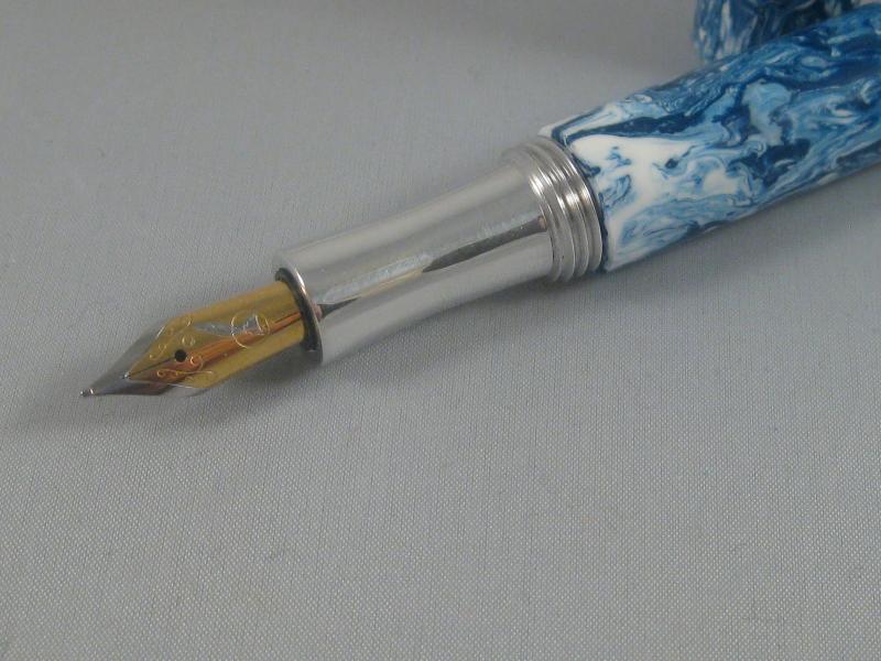

Here is an example of what I am talking about; it's a front section I made on one of my original designs.

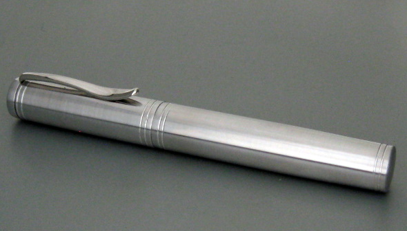

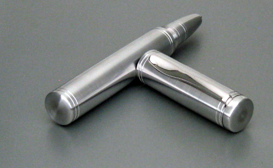

For a brushed look, I wet sand with mineral spirits 220, 400 and 600. If I want a high polish, I then use Mothers aluminum polish with a blue shop towel then the white micro fiber cloth.

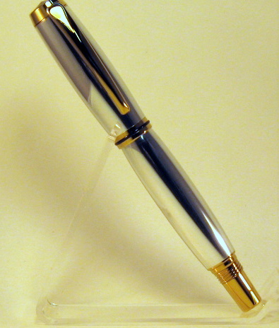

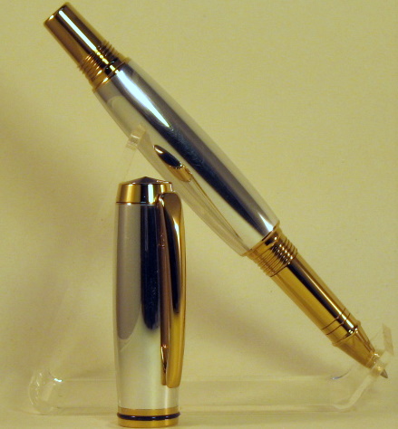

Scott, I thought I would show you a couple of options since I have them available. One brushed as mentioned in my other post and, one polished. I like both. As Gary said, a protective coating will help with the scratching issue.
