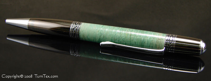

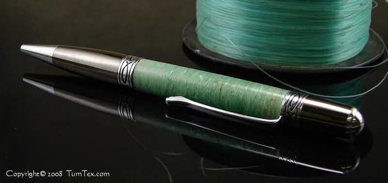

Here is an easy one to make that fits any fisherman.
attachment.php
Just put your tubes on the lathe as if you were going to turn them. Then take some fishing line and use some CA to glue the end to the tube. Then use your hand wheel (or slow speed if you lathe goes slow enough) and wind the line on. Make one pass and coat it with CA very liberally. Allow the CA to cure and then keep going until you have it built up bigger than your bushings. Then simply turn it down. You may need to add CA as you turn. You can also use different colored fishing line and even combine different colored line. It is more interesting in person than in the photo.

Maybe I could combine fishing line with a logo to make a really nice pen. Wow, you guys have given me some really great ideas. I hope my friend wants lots of pens because I want to try them all!
