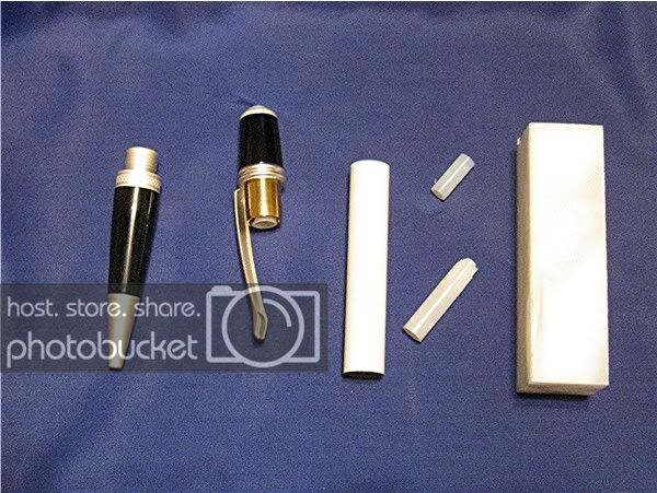

Using these parts...

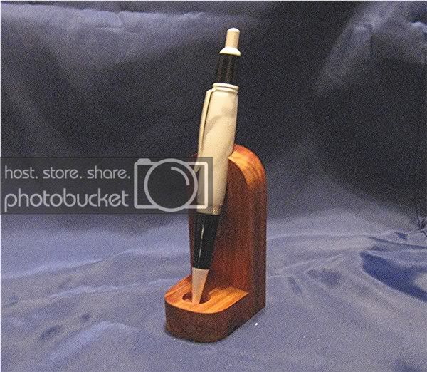

I made this pen...
The white pen tube is from Woodcraft, and it's sized for the standard, non-click Wallstreet II. The small adapter shown above the Fisher mechanism is a nylon 3/16" sleeve. When cut to slightly less than 1/4" it slides inside the Fisher part, preventing upward movement of the refill. Once the 1/4" spacer is installed, it does not come out easily. I've used it for over two weeks without incident.
I apologize for the poor quality of the pictures.
