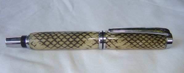

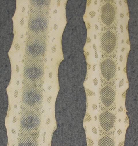

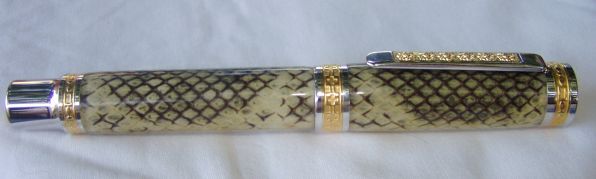

fish skin should be tanned therefor no smell, the cutting process to the lenght of the tube is time consuming and you will all way see the seam, I did Barramundi fish skin, got some cane toad skin ( frog ) to try and Australian sea snake. be carre full if you pressurise the blanks, pressure will inject to PR into the leather of the skin and the blank will turn black :frown:
Australian sea snake Baron
Australian sea snake Emperor
