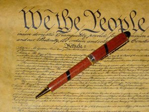

The top pen is Bloodwood with ebony inserts. After I made the cuts, I found the gluing was going to be tricky. I wound up clamping to the workbench so that the pieces wouldn't slide off the angles. Gotta find a better way.

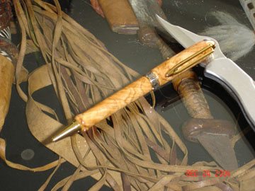

Next is a piece of Cherry Burl.

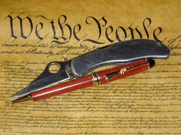

Third is Red Heart.

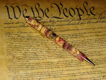

The Bottom one is dyed Maple Burl. The Blank was entirely dark wine red, but as you can see, penetration was poor, so a lot of the natural wood showed up, I showed it to several people who had a hard time believing it was wood. They thought is was marble or plastic.
