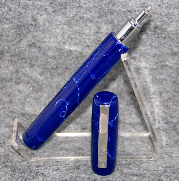

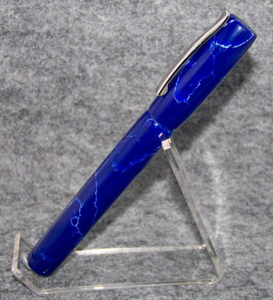

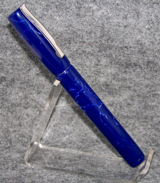

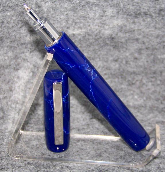

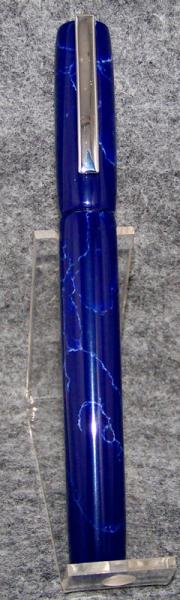

Trying to take that next step in my pen turning game. I don't know if you could call this truely kitless bc I used ancient parts from pens I used in highschool. I don't have the means to make my own nibs and internal parts, but I think I had to think outside the box to make this pen work. It takes a parker refill and I used an extender from a sierra click kit but had to shorten it a little to make it all fit nicely. It's a double closed end with a snap cap and hidden clip. I chose the design of the pen to flow with the boxy nib section. I had to use every single 1/8" of the blank to have enough room for everything (All thats missing is from the kerf of my bandsaw blade). The blank is a Sodalite trustone that I MM to 12000, Buffed with Tripoli and White Diamond, and polished with PlastX. I really enjoyed the challenges of making this pen. I also have to give a big thank you to Hans for doing his hidden clip demo this past Sat. I used alot of what he taught to make this clip work. Thanks for looking and any comments/critiques/questions welcomed and appreciated!:biggrin:

That is a really cool pen! I am very interested in how the cap works. If i am not mistaken, the little ledge on the front of the nib section is one half of the setup, the other half is in the lid yes? What is it made of? The section in the lid that is... Thanks for posting this! It opens alot of ideas for me!

Thats right Ron. That little ledge snaps into a plastic insert in the cap. that insert has a slight taper and that ledge will push past the tapered part securing it in place. I'd take a pic but I epoxied it in place already.
