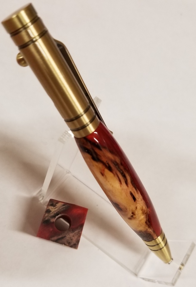

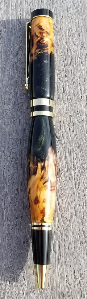

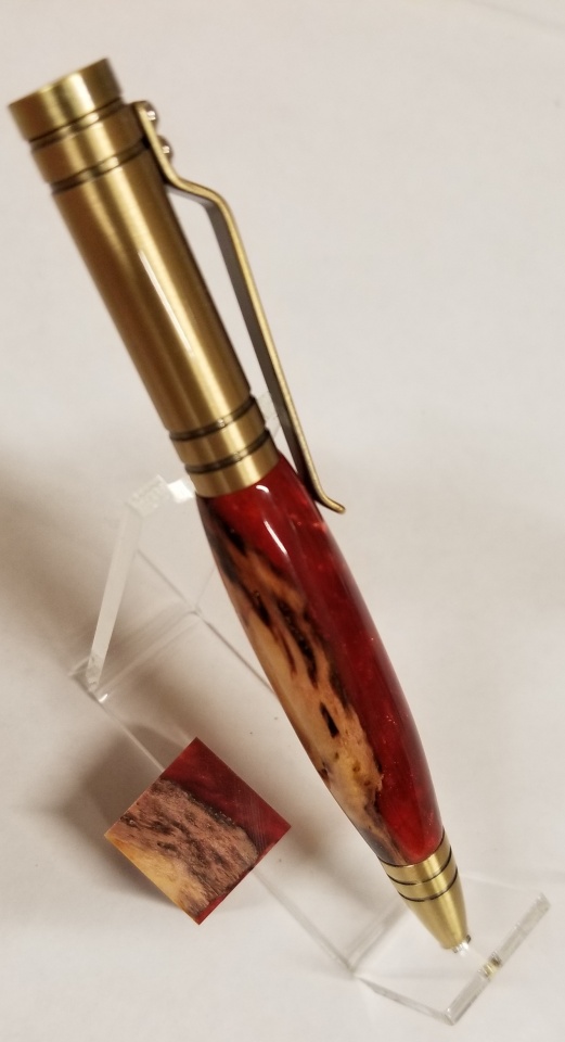

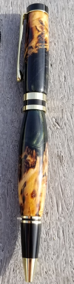

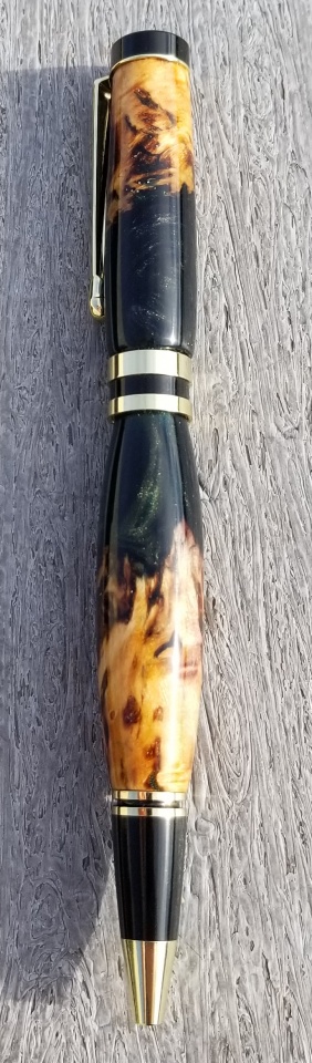

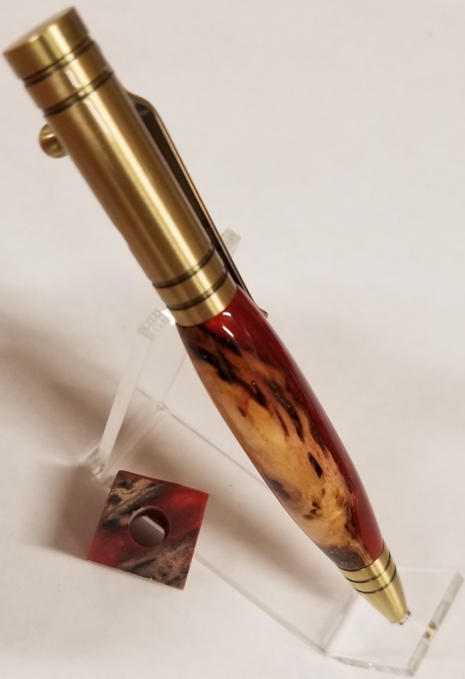

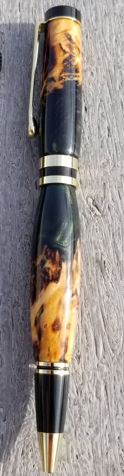

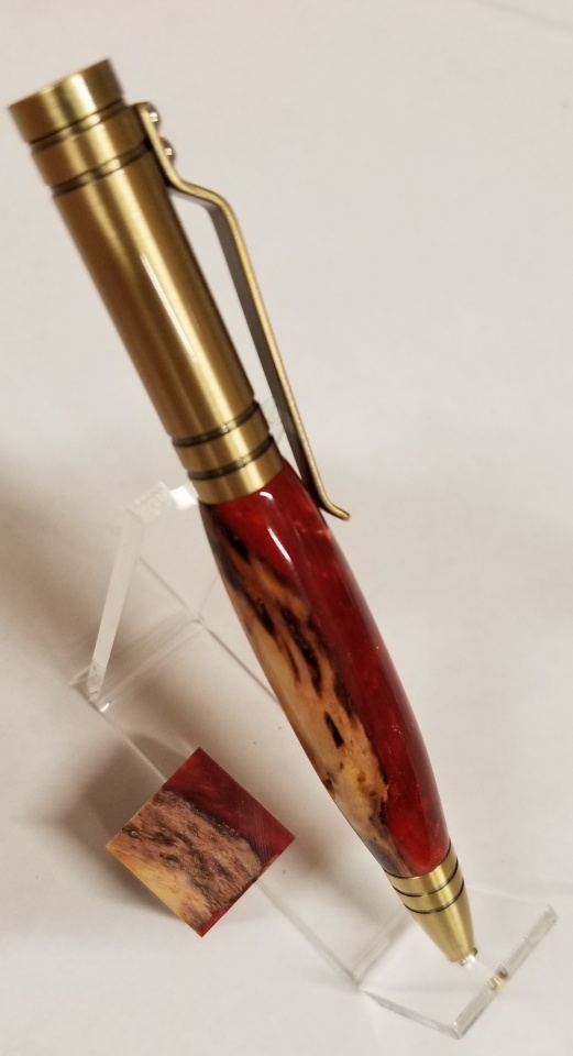

First two trys at worthless wood casting and turning to see what they would look like.

Excellent looking blank castings !!
However, I am not a big fan of the shape to which you turned them ... a little too "bulgie" for me. . I like a little bulge on some kits but not that much, and I would turn the Tec pen blanks almost straight. . Just my opinion for what it's worth.
It seems that you are well on your way to being self-sufficient for really pretty blanks !! . Well done !!
VERY nice website you have created !!!!
I think the blanks turned out great but I'm with Mal on this one. Less of a bulge would produce a better looking pen with both kits IMO. The blanks themselves are fantastic, and a little reshaping would take them from "nice" to "beautiful".
I too would like to know more about what you used to create the blanks.

Ended with 5 coats of CA and sanded and polished.
I wasn't sure about the CA, but the wood seemed to need the extra coating vs the alumilite.
