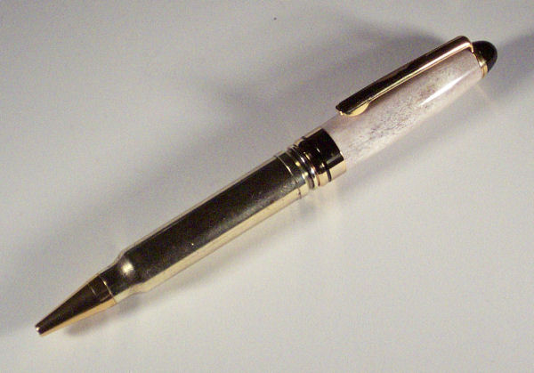

First try at a cartridge pen. Cartridge is a 338 winchester that had been fired. Almost a perfect fit for the 8mm euro. Had to take about 1/8 inch off the cartridge at the nose end. 5 minute epoxy inside the cartridge and a little tape to hold the nib centered while everything hardened worked wonders. Ti gold euro kit and the cap is deer antler. It will be a gift to one of the hunters in the area who gave me the shell, and 3 small antler racks.

Nice Job. I have made 6 cartridge pens so far and everyone has a home. I haven't tried the scratch way yet I am still on the kit way. Keep Up the Good Work.
