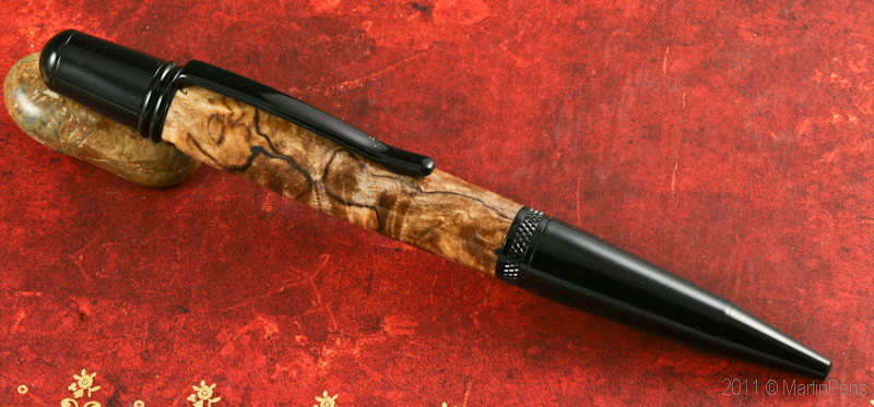

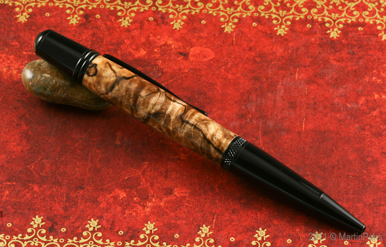

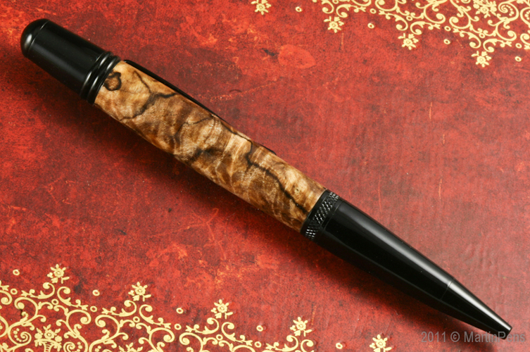

This is stabilized spalted maple from Oregon. It was so punky and brittle that I could snap it easily. Some of it was even dusty.
Stabilized in the Cactus Juice Chamber I won in the IAP Bash. :party:
I cut it long instead of trying to drill through a blank cut at length.
Ends are squared with the standard blank squaring drill attachment. Next time I will knock the corners off on the bandsaw or with the belt sander.
I used a sharp tool and took my time. Turned it proud of the bushings and sanded it to match bushings. I use 220, 320 & 400. 2 coats thin CA and 4 coats medium CA. I touch the tip of a skew to where the bushings meet the blank for separation. 400 light sanding and then micropads. Beale three wheel polishing/buffing and then to the light tent.
Hope you don't mind the details. I've seen lots of newbies on the sight and wanted to put a little method in the thread.
I chose the black Sierra kit because of the challenge in having it so thin. I really wanted to see if it would hold up or if it would crack.

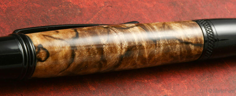

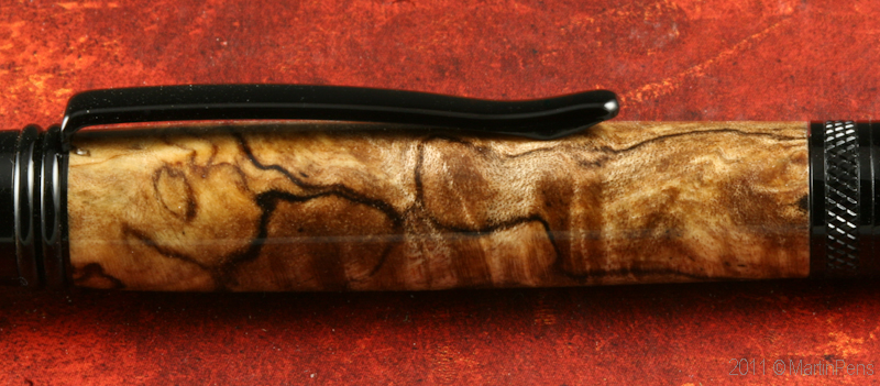

In the photos I tried to get one with a lot of reflection, which isn't easy to do with my setup. The nicest part of the stabilization is how it makes the grain shimmer and pop inside.
When I get more juice and do a few more batches of stabilizing, I'll be offering these blanks in the individual classified section.
Comments are welcome. Thanks Curtis for the great prize!
Martin

Martin looks like you did a nice job! I like reading the details on the posts. I admit I normally don't include too much detail myself anymore unless it has to do with the mishap I had while turning or something else. The fit and finish looks nice. I like the wood and the choice of kit as well.
That's some beautiful wood and it really goes well with that kit. Thanks for showing it and the added info.

Martin, I really like it and it works well with the kit! Spalted is really difficult to work raw and it's great that you're informing the newer turners what needs to be done with this type of wood.
Martin, You did a great job of salvaging some wood that turned out beautiful. Did the wood darken some as you infused it with the resin?. Looks gorgeous particularly the darker wood on that kit. Fit, finish and photos are excellent as usual. Thanks for showing. Regards, Doc P.S. You are lucky..I tried to order a system and...they were out...:frown: Curtis is probably making some more.:smile:
Doc, right out of the chamber they look significantly darker. But after they cure in the toaster oven they lighten up again. I will do a comparison and post a before and after pick. Quite honestly the resin was great improvement to the blanks. It made the grain shimmer. I don't think they are any darker at all. The CA glue darkened and enhanced them a bit, as it usually does, but the grain shimmers more. I'll take some stage picks and post on this thread soon. Martin

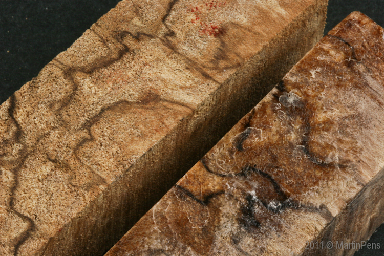

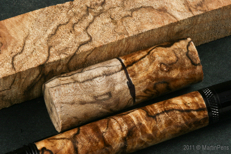

before and after
So here the top blank is before stabilizing and the bottom is after. The second shot is an original blank unstabilized, a round cutoff with the left side sanded with no CA and right side with CA finish and then the finished pen. You can see, hopefully clearly, the salvage that was done with the juice. More juice on order. Doing a large batch and then making some of these blanks available on the forum.
