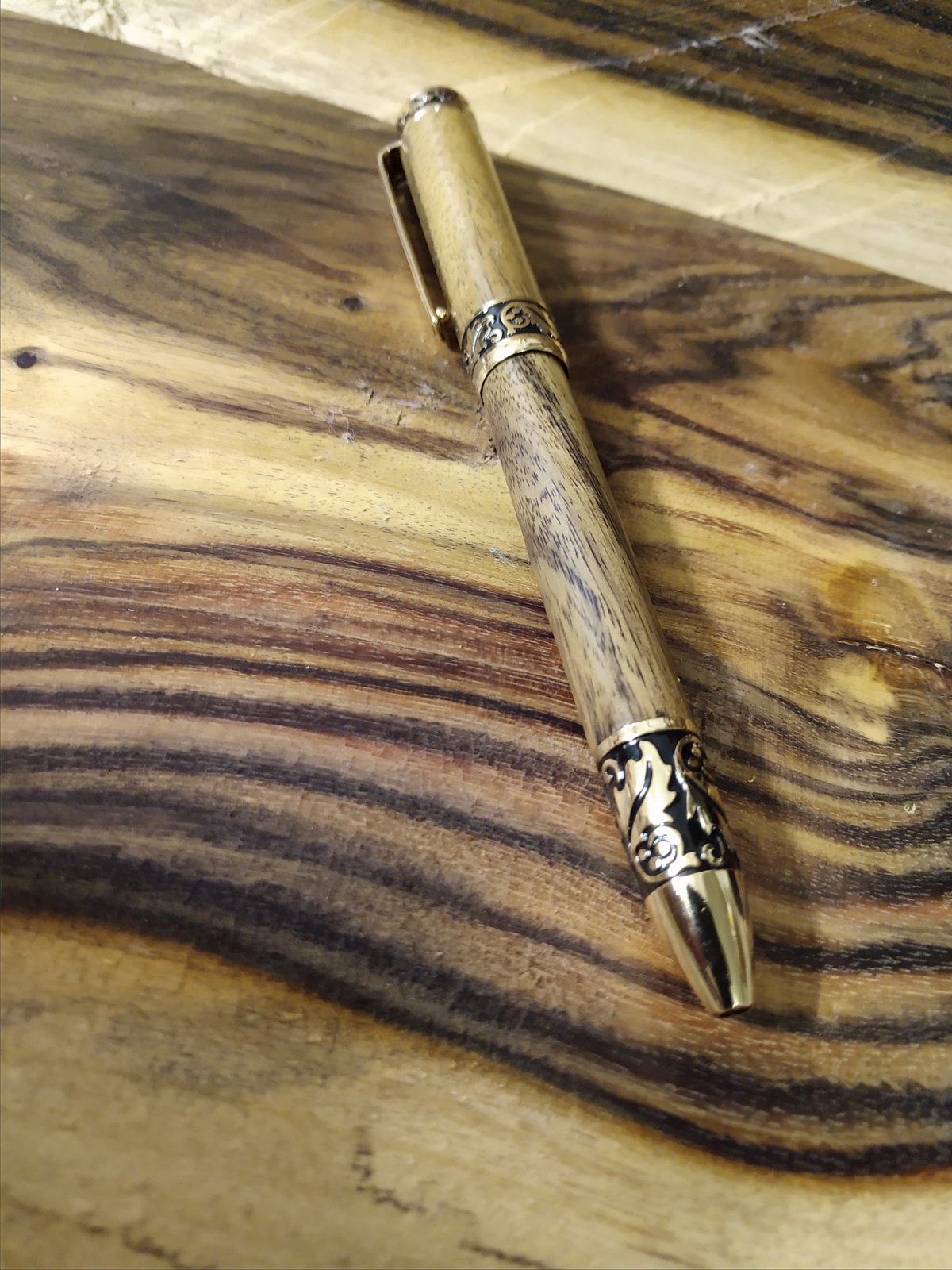

Used Texas Ebony for this kit. It is going to Canada for a Christmas present for the Grandma in law.

That's a beautiful pen. Well done!
