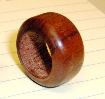

D dscott Member Joined Apr 4, 2005 Messages 200 Location Cleveland, Tennessee, USA. Oct 16, 2007 #1 it is not the greatest but it is my first wanted to see if i could make one now i can try to make some worth something thanks for looking
btboone Member Joined Dec 5, 2004 Messages 2,421 Location Roswell, GA, USA. Oct 16, 2007 #2 Not bad David. You can laminate some different woods in different grain directions to improve strength so the thickness can come down. It also has the potential to look pretty cool when doing that.
D dscott Member Joined Apr 4, 2005 Messages 200 Location Cleveland, Tennessee, USA. Oct 16, 2007 #3 thanks i have seen your rings and they are great Again Thanks
btboone Member Joined Dec 5, 2004 Messages 2,421 Location Roswell, GA, USA. Oct 16, 2007 #4 Just use CA on the inside to fine tune your sizing. The acrylic also creates a barrier to some woods that might cause a reaction.
