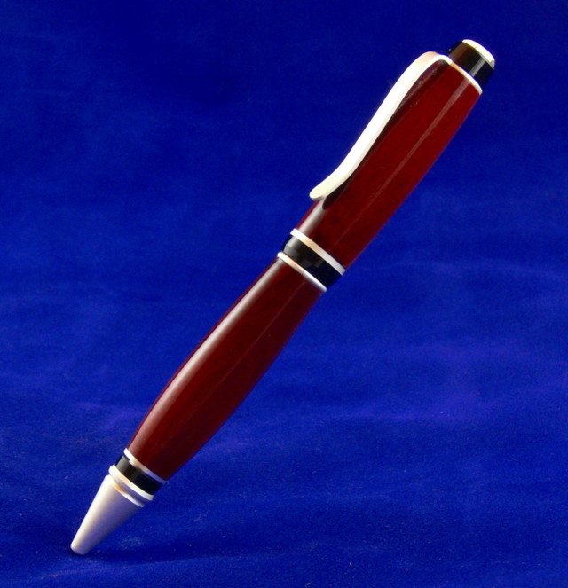

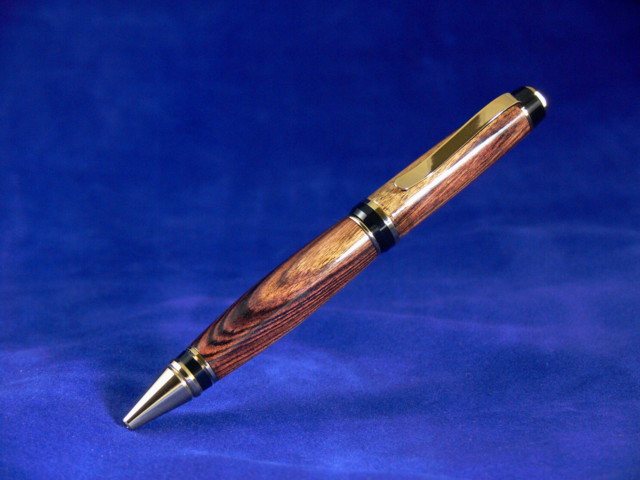

Ups just delivered my new light tent I bought on EBAY. These are my first attempts at using it. I'm not much of a photographer so any comments or suggestions of what I could do better would be greatly appreciated.
The backgrounds came with the light kit. The kit has two light tents, one 12" and one 30". There are four backgrounds for each size, red blue black and white. They are similar to velour.

I believe that both your photographs show decent composition, BUT are just a stop or two overexposed. The clips and barrel ends are to brightly lit. To fix the clip - turn the pen a little bit to avoid such a hot shop on the bright metal. It's kinda like looking at a reflection of the sun in a mirror. The metal tip - well, that takes adjusting the exposure and the light placement. Ahhh, the beauty of Adobe Photoshop ($800) or one of the others - just as expensive.

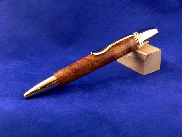

Fred has some great detailed advise. My only point is that your block of BOW needs to change. Either find something else, or smooth up the edges. I found myself looking at the rough edges instead of the pens.

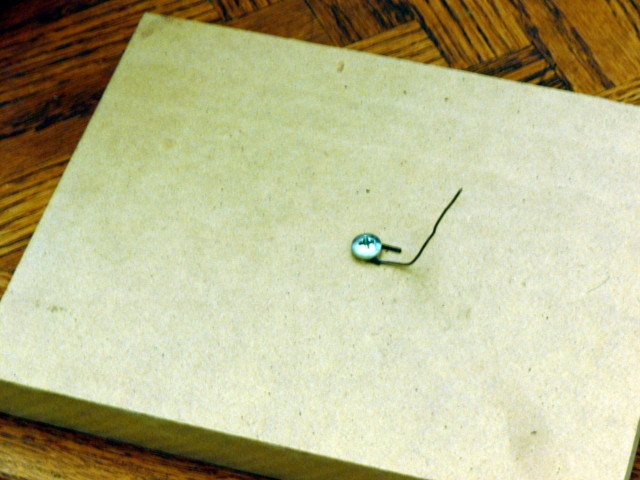

thanks for the reply fred, good info. also, could you elaborate a bit more on the small guage wire up through the bottom? i didn't quite follow how it would make the pen stand?

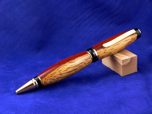

Thanks for all the advise.I'll try it again this evening using your suggestions.the camera is a Panasonic FZ30. It has a good set of controls so I should be able to get the exposure corrected.The lights are 30W 5000k CFL bulbs in reflectors. Came with the light tent.

Well, it looks as though you figured out the wire idea. Great photographs and I do believe they are vastly improved upon. Now you need to play with the exposure a bit to see if you can catch a bit more detail in the wood and other surfaces. Be consistent with the pen placement and IF you ever need to print the pictures out everything will be uniform which in turn is much easier for a viewer to consider.
ahoiberg .. I use a stiff wire from Hobby Lobby. I bend a small circle about 8" in diameter and then bend the wire towards the center point. I then bend the wire upwards at whatever angle I need to use and push it through the background material, being careful to not rip the paper/cloth material. Sometimes the product will be a bit heavy and then I simply tape the circle part to the table under the background material.
One CAN make the pens float by wedging the tip up a bit on the wire away from the bottom where it enters the background material. You might have to "touch-up" the wire below the tip if it reflects the lighting. This is often accomplished in a program such as Corel Draw or Adobe PhotoShop. Be prepared to take out a small business loan for either of these as they are very pricey to say the least.

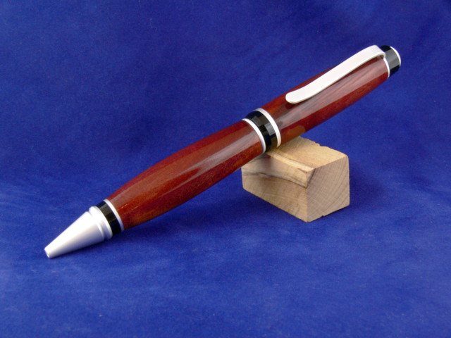

the photos look well framed and composed, however i agree that they're still a little dark to see the details of the pens. nice work on the floating part. i've always hung wire from the top of my photo box and clipped the pen over it and had to photoshop out the wire. kindof a pain. i've been thinking of using fishing line, that should be transparent to most backgrounds... maybe i can figure out what you're doing! that looks nice.

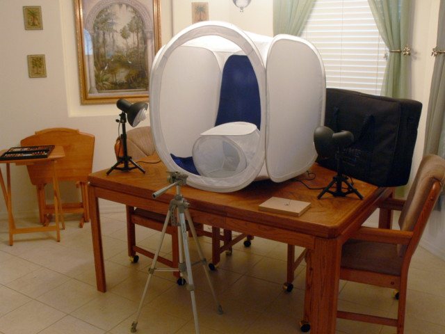

The light tent is from Square Perfect off EBAY. It cost $107. It comes with two light tents, one twelve inch and one 30 inch, and four backgrounds for each size. mIt also includes two 30w 5000k CFL lamps with reflectors and small stands. They also through is a pretty fair fullsize tripod for your camera. It's all packed in a big suitcase.
The first pictures were made using the small tent. As Fred suggested I switched to the larger tent for the second set.
The pen stand is nothing more than a paper clip staightened out with a small loop on one end. I sharpened the end on the grinder and screwed the looped to a 6"x6" piece of MDF. Bend it to whatever angle you want, slide the whole thing under the light tent, and poke the sharp end up through the bottom of the light tent and the background material. Remove the ink cartridge from the pen and slide it over the paper clip. Instant floating pen!!
I'll post a picture tonight of the setup. Right now I'm going swimming.

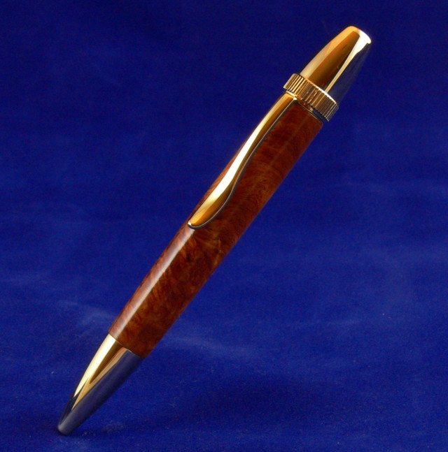

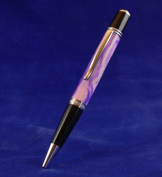

I spent a bunch of time screwing around with lighting and exposure. I think I need a third light a of little smaller size to add a little more sparkle to the finish. This is the best I was able to come up with using the two lights. I think it's a big improvement to my original efforts. Thanks for all the help!!!
