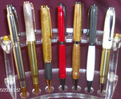

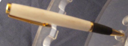

Josh and I finaly decided to post photos. These are a few of the ones we have done. We are still working on getting good photos. We made a tent and used a HP 627 still not happy with results. Any comments on the pens or photos are welcome.
Shawn & Josh
Image Insert:
Double cartirdge, Cartridge antler, Canary wood, Corian, Canary, Corian,Cartidge antler

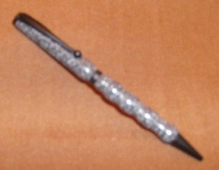

Corian Josh turned. having trouble getting good photo.

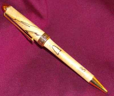

Spalted Maple

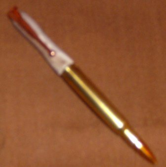

Antler 30-06

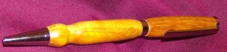

Canary

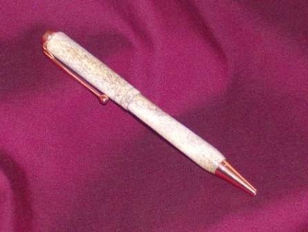

Antler
Antler
As you can see some photos are good most are out of focus or light is wrong. Look forward to critique
Shawn & Josh, I won't address the photo help as I would just banter off some BS to make you feel good:D
While each to their own I feel saddened that such fabulous material has been sacrificed to the low end kits. I would be interested to know if they sell for much more than 'regular' material.
I can't see the blurred pics well enough to comment. I like that you have done away with the centre band on the antler. It looks OK from what I can see.
Your Canary wood is under turned, that's why you can see the much lighter band where the cap joins at the CB. The angle of the pic also makes it look as if you have used two different pieces/colours.
I am sorry to say but I believe you spalted maple is very seriously under turned. The bottom section is much too narrow as it looks like it would be perfect for a straight slimline.
Your cap is way too thin until you hit the CB and it is way too over sized in comparison. I would say it looks as if you were turning a slim line and realized at the last minute it was for a different kit.
Some smudges on most of the metal as far as I can make out.

Ruth,
You are 100 % correct on the spalted Maple. This was the first Euro I did. It has taken some time to get use to turning them. Yes we did use base kits, but we have only been turning for 3 months and did not want to use better to start. The metals were not smudged, I think this is from the phtography. More shows up when you take the pictures. I posted these here as I thought comments from other turners would be heplfull. We are learning more each time we turn.
Shawn
It looks like you are well on your way. I agree with Ruth on what was said.;) Just slow down, use a caliper, tripod and a paper towel to wipe the pen down before you take the picture. I always slightly angle my tool rest out in the middle of the blank when I get close to the end. Then I go back and hit it straight accross at the very end so it's not bulbous yet not bowed in.
